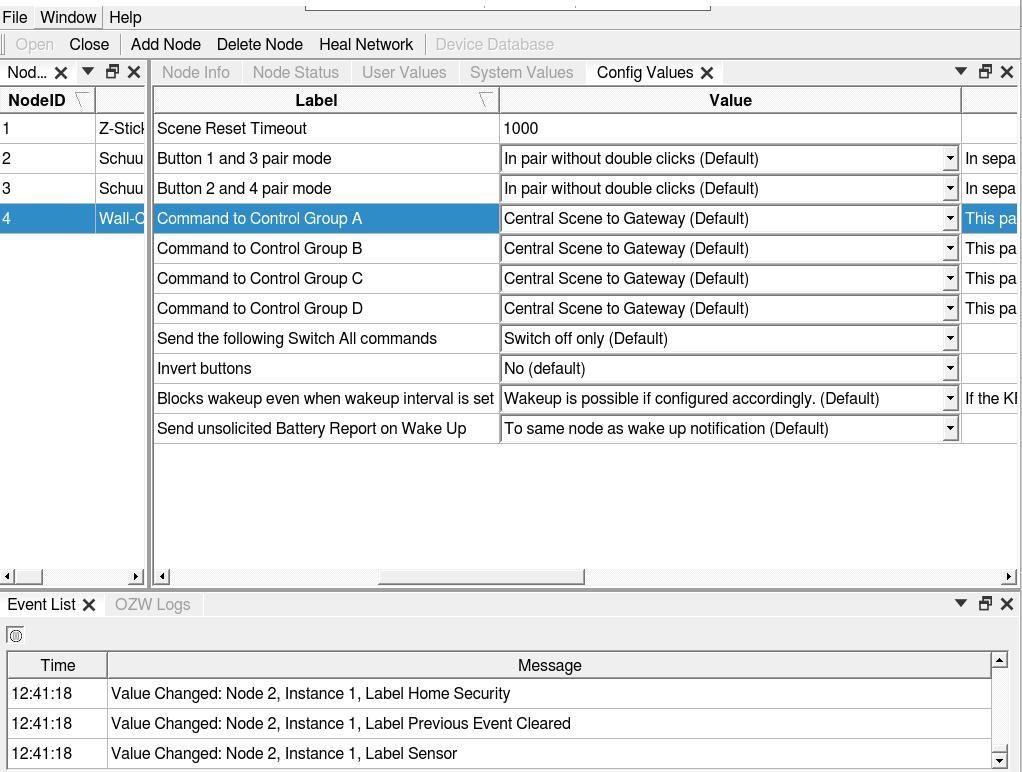

Ok, so sorry if I am hijacking your question but I think mine is the same. Also using the new openzwave integration and have successfully added my wall-c switch. is included successfully and showing button presses. But I do not seem them in home assistant/node-red.
Below the current setting in openzwave. I have tried to also change all 4 “Command to Control Group” to “Send Scenes” but that was not helpful too. I think this is the same question as your because I also do only see 1 entity in home assistant.
