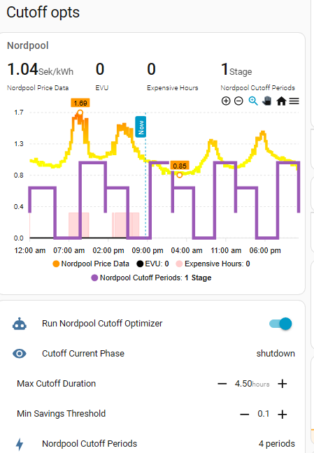

Hi, I really like the script you created for its simplicity! It’s way less complicated than some of the other dynamic price optimization tools out there.
I have been wrestling with getting it to work. One tip for those out there using e.g. euro as currency is to set the cutoff base price diff significantly lower to make sure you get cutoff periods.
I feel I am really close but I am stuck as the periods don’t have any date/time associated to them. An example:

Hi @wolter1 — thanks a lot for the kind words, and for the detailed debug info!
About the empty timestamps (preheat_start, shutdown_start, recovery_start, recovery_end): those fields should normally be populated when the optimizer can read proper time-ranged slots from your Nordpool sensor (each slot should have start and end).
To narrow this down quickly, could you share a bit more info?
  1. Which exact version are you running?
  • Is your /config/python_scripts/nordpool_cutoff_optimizer.py copied from the GitHub repo v2.0.0 release? (Not a v1.x script.)
  • And are you using the v2.0 template sensors (not the older ones that referenced shutdown_end)?
  1. Which Nordpool entity are you using, and how is it passed to the script?
  • In your automation, do you call:
    service: python_script.nordpool_cutoff_optimizer with data: { np_entity: <your_nordpool_sensor> } ?
    (v2.0 supports selecting the Nordpool sensor this way.)

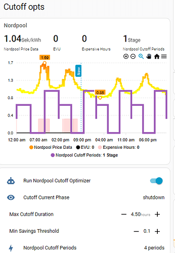

I managed to get some visualization, but not sure I fully understand why it cuts-off so early compared to price peak…

Thanks for your work, @nikop . I’m thinking of adopting your solution to cabin heating to preserve minimum temperature while minimizing heating costs. Our cabin is heated with electricity and with the enormous fluctuation in prices it makes sense to preheat the cabin so that the heat lasts over the expensive period.
Given this use case, is “recovery” mode really needed at all? Is there a downside with blasting the heating at HIGH from the get go once the prices drop?
Secondly, I’m finding that some electric heaters act differently from others: an oil radiator takes time to start producing heat and it’s produced quite locally, so 1-2 C increase can be quite significant. However, a blower heater produces heat very fast but also results in a larger temporary spike so an increase in 3-4 C is needed for it to “count”. This difference seems to be dependent on how cold it is outside: if it’s cold the spike is smaller → less increase is needed. I wonder how your solution should be adopted to different heaters being used?
Hi @alizbazar — thanks for the thoughtful questions, and your cabin use case is actually a perfect fit for this approach. You’re already thinking in the right direction: protect a minimum temperature while “shifting” energy into cheaper slots.
  • Recovery isn’t mandatory — it’s mainly there to avoid overshoot and unnecessary power spikes after a cutoff. If your cabin goal is just a safe minimum temperature, you can often shorten recovery a lot, or replace it with a simple step ramp (e.g., Medium → Normal) instead of “blast HIGH for long”.
  • Treat your heaters as different “roles”:
    • Oil radiator = baseline / temperature insurance (stable, slow, good for riding through expensive windows).
    • Blower = short boost tool (good for brief preheat or a short controlled return; easiest to overshoot if you go full power too long).
  • Outdoor temperature matters (you already noticed this): colder weather = higher heat loss, so boosts/cutoffs behave differently. If you can, use weather-aware tuning or separate “mild vs cold” settings.
