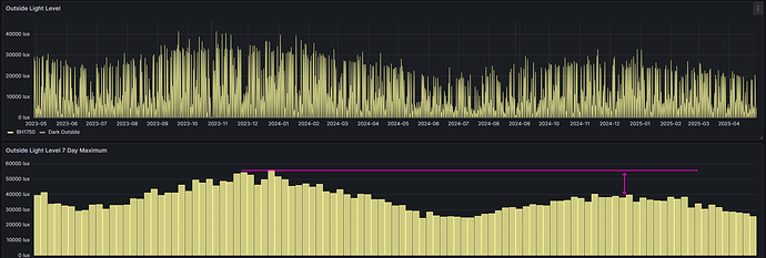

For anyone that has constructed this sensor I have a word of warning. Either the sensor or (more likely) the white plastic dome covering the sensor is aging badly, causing a reduction in output with time (years).
I use the sensor for lighting control and to get an estimate of my solar efficiency. However I noticed that my solar panel efficiency was getting better with time. Hooray!
Maybe not.
After a year or so I recalibrated my template sensor only to notice the increase in efficiency still slowly occurring.
I double checked that I had not done something stupid in the template calculation. I had not. Which meant that my measured light level must be decreasing with time. Looking at the BH1750 maximum over two years clearly shows this:

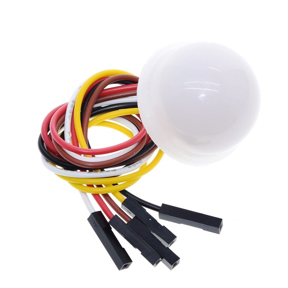

The plastic domes that come with these sensors are not UV stabilised:

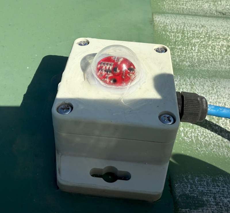

I replaced it with a 25mm diameter glass half dome bought from a bead & crystal shop.

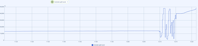

LUX reading went from 14,000 to 48,000 :open_mouth:
Word of warning about the glass domes. They are cheaply made and often have a thicker “drip” of glass at the top of the dome. This can act like a lens and could easily burn the PCB. I sorted through 4 or 5 before I found a nice even one.
