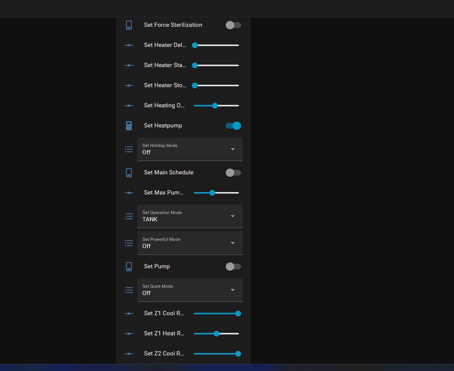

I still have to solve the problem from point 2). I cannot set the temperature for heating, because there is a limit of max +5 degrees. I have set the water temperature control, not the heating curve correction.

The temperature setting is in " - platform:panasonic_heatpump; set5: name: “Set Z1 Heat Request Temperature”.
From Top 76 you are right, I have it set to “direct”
For now I have downloaded the library and I am using it locally. In the files I changed the range to from -5st to 5st to 20st to 60st and temporarily managed to set it.
As for the climate entity I tried to make it “climate: thermostat” but I don’t know why, after posting such a line the ESP32 hangs completely and loses communication via WiFi. To unblock it you have to remove the climate:thermostat line and reload the program via USB. Currently I am trying to create the climate: template entity in Home Assistant but I have huge problems with synchronizing it. After switching on from the climate switch card “heatpump_set_heatpump” turns on for a moment and then turns off again automatically. There is also a problem with tracking the current mode
Ok I will try to change the min/max values of number entity “set5” and “set6” depending on the text sensor entity “top76”. Same also for “set7” and “set8” which shall depend on “top81”.

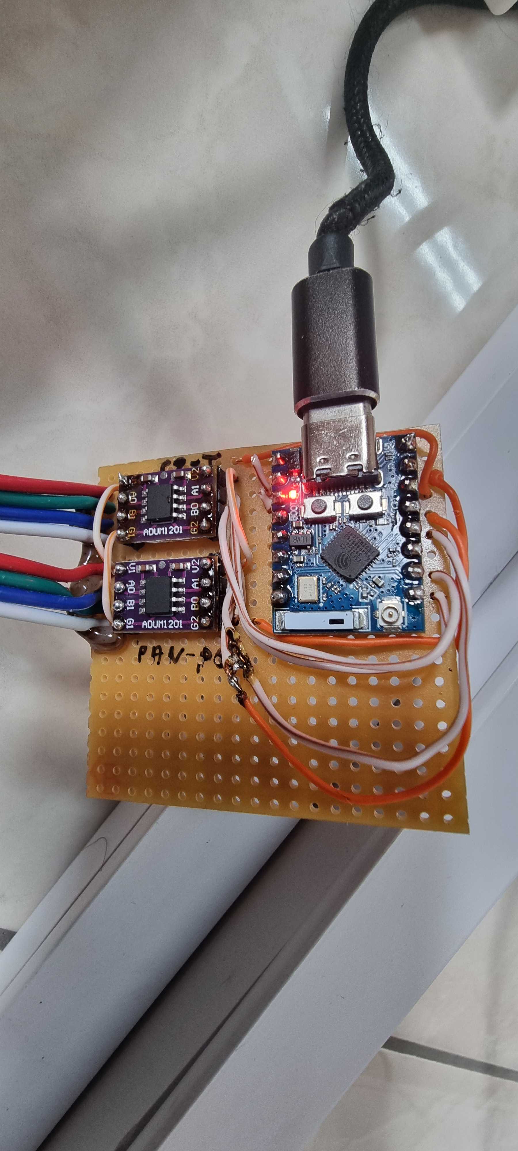

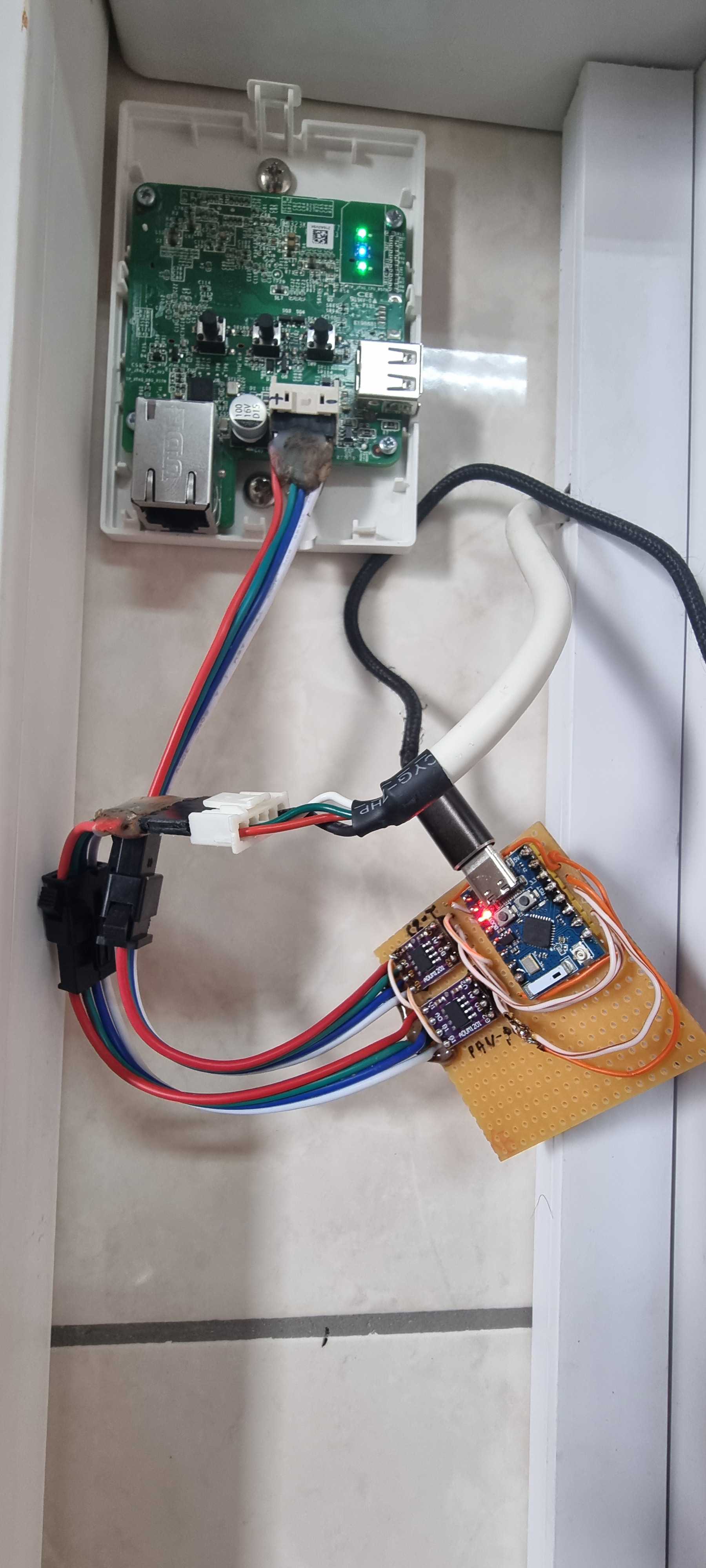

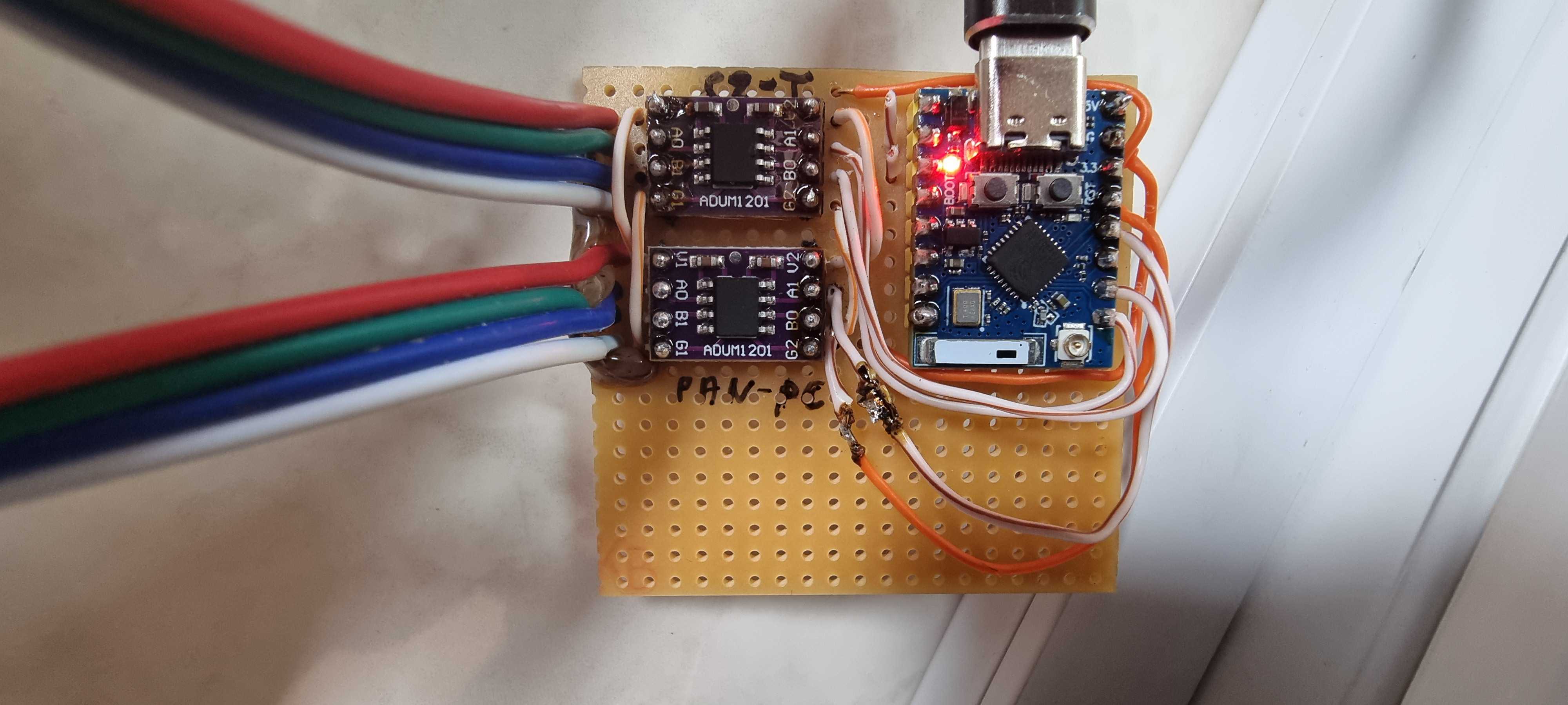

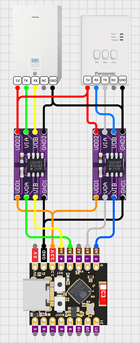

In the last days I also experimented with the ADUM1201 Dual Channel Digital Magnetic Isolator. So far it worked quite well und runs very stable. Here my wiring:
While testing I realized that my ESP32-C3-mini has very bad WiFi issues. If I connect all pins to e.g. a breadboard it can almost not connect over WiFi. But if I connect only one have of the pins (do not connect GPIO5 to GPIO21) it’s working much better.
Now I will try the ESP32-C3 SuperMini Antenna Mod. Hopefully it will fix this problem.
But for the future I would recommend to use an other board e.g. the Wemos S2 mini. It should not have these WiFi issues.
I created a new wiring because in the last image the connectors were swapped (at least for me).

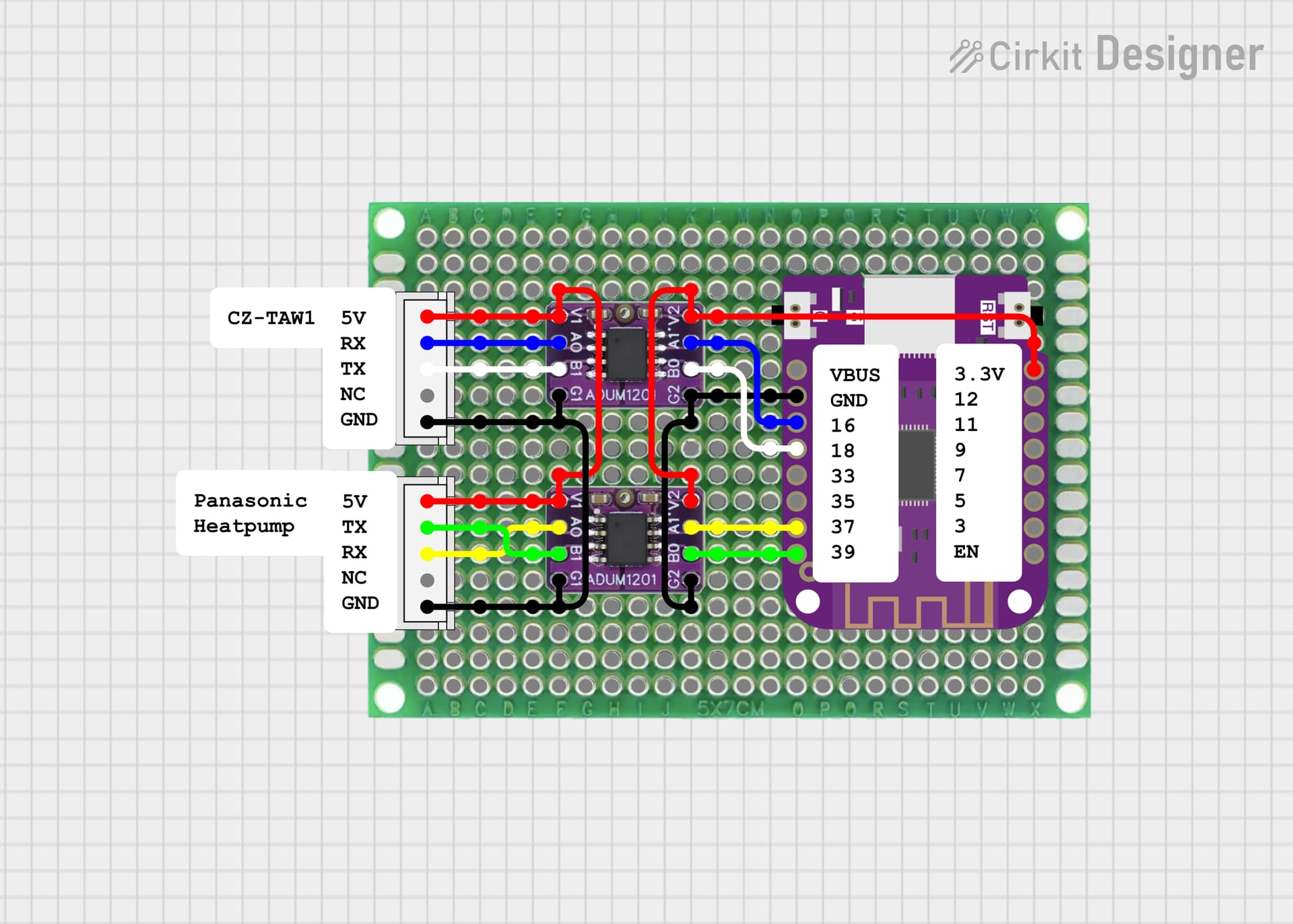

Does someone have the pin mappings / Esphome template for the HeishaMon Large board (from TheHogNL on Tindie)?
You can create an issue on HeishaMon Github and ask for the pinout/schematics.
But it should also be possible to get the pinout from the HeishaMon.ino file.
Heatpump RX: GPIO18
Heatpump TX: GPIO17
CZ-TAW1 RX: GPIO9
CZ-TAW1 TX: GPIO8
LED PIN: GPIO42
