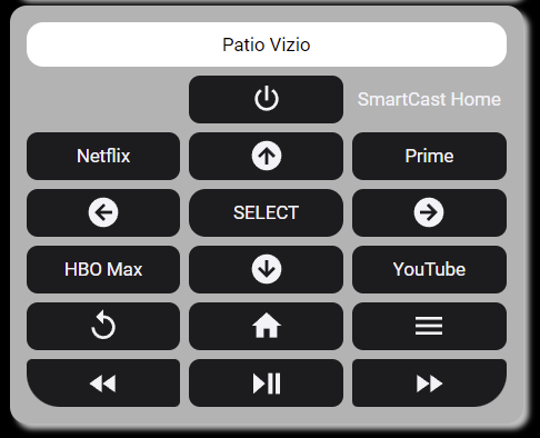

So now I have a totally functional Vizio remote control like this:
With a rest_command template like this:
vizio_processkey:
url: "https://###.###.###.###:7345/key_command/"
method: put
content_type: "application/json"
headers:
AUTH: XXXXXXXX
payload: '{"KEYLIST": [{"CODESET": {{ codeset | int }},"CODE": {{ code | int }},"ACTION":"KEYPRESS"}]}'
verify_ssl: false
Now delving into handling the IP address(es) and auth codes for all the televisions.
