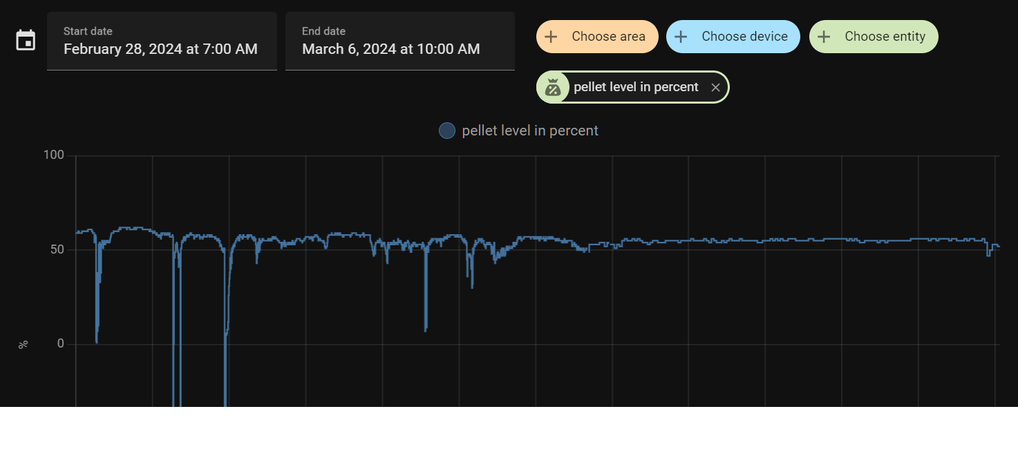

Hello!
I have a question! I’ve had the sensor mounted on my stove for a while. The main problem is that most of the time, it says it’s 98%. Once it starts working, it starts to take real values. Is this a vibration problem?
Vibration or slope of pellets
Might have to adjust bracket, location or angle.

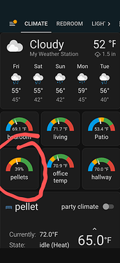

I have some false reading when pellets are feeding but minimal and my automation adjust for that.
I’m very happy with mine.
changed the update interval to 5 min for less false readings.
