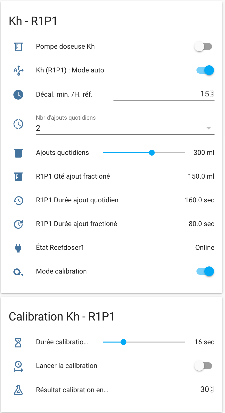

I modified code because I missing a “(”. It work now.
I will add choice for calibration time because I have pumps with 87ml/min and 7ml/min.
OK this finally works correctly.
It include, calibration, choice of calibration time, instructions by notification via HA app, notification if pump is outline
The code is :

Final look when all is developed :

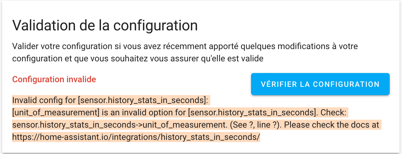

@cowboy When you put the modified component in custom_component it’s automatically take in account by HA ? I find the original component on HA web site but could i have a direct access on HA ?
It still me to find how to reset the value ?
Something is wrong when I use the custom history_stats_in_seconds
Any ideas ?
Strange. However, I don’t actually have it in custom_componenets - it’s in the same standard components directory that history_stats is in. Cheeky and not recommended but works for me. :slight_smile:
I deleted the unit’s measurements and it’s work.

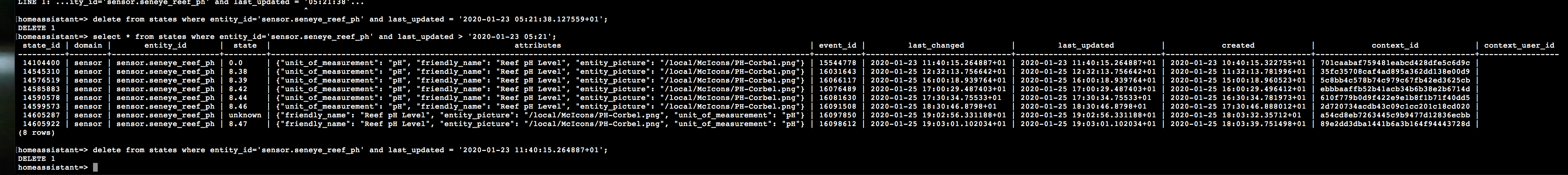

I always need to find how to reste history of one sensor
Did you figure it out? I just had to do this myself …
I doesn’t find how to reset history of one sensor.
Like you a did a custom history stat for the seconds. I don’t use the last ligne of unit and it works great. I place it in custom component.
Actually calibration work fine and history’s stat work to have a quick look of flask content. Have you test it ?
I still need to reset sensor when flask sensor is empty to reinitialize it.

I will try to explain how the tracker work:
I used an input number to put the volume of these flask:
reefdoser1_pump1_flask:
  name: volume du contenaire plein
  min: 1000
  max: 10000
  step: 100
  unit_of_measurement: ml
  mode: box
  icon: mdi:bottle-tonic
I set the value of 5 litres
I used history stat sensors to track the delivered qty in seconds as :
sensor:
# Historique utilisation
  - platform: history_stats_in_seconds
    name: R1P1 distri total en sec
    entity_id: switch.pompe_doseuse_kh
    state: 'on'
    start: '{{ as_timestamp(now().replace(hour=0).replace(minute=0).replace(second=0)) }}'
    end: '{{ as_timestamp(now()) }}'
and other sensors like :
- platform: template
sensors:
# Stat of delivery volume
      r1p1_distri_total_en_ml:
        value_template: "{{ (float(states('sensor.r1p1_distri_total_en_sec')) * ((float(states('input_number.reefdoser1_pump1_calibration_dosage')))/(float(states('input_number.reefdoser1_pump1_calibration_time'))))) | round(2) }}"
        friendly_name: 'R1P1  distri. total en ml'
        unit_of_measurement: 'ml'
        icon_template: mdi:chart-histogram
      r1p1_vol_restant:
        value_template: "{{ (float(states('input_number.reefdoser1_pump1_flask')) - float(states('sensor.r1p1_distri_total_en_ml'))) | int }}"
        friendly_name: 'R1P1 volume restant'
The first to count the amount of volume depending on calibration.
The second to calcul still volume of the flask.
I’m thinking to reset the history sensor when I refill the flask but did not find out how to do it.
Another problem when in restart HA it sometimes seems to reset the value.
