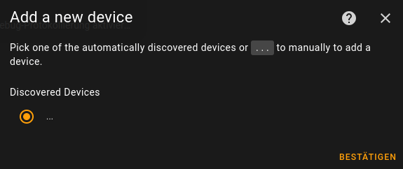

Hi, i have one of those Honeyguardian S30D but unfortunately my localTuya cannot discover the device… was there maybe some change in the past or am i missing a step? (first local tuya device…)
grafik
bump. please see if you could assist.
