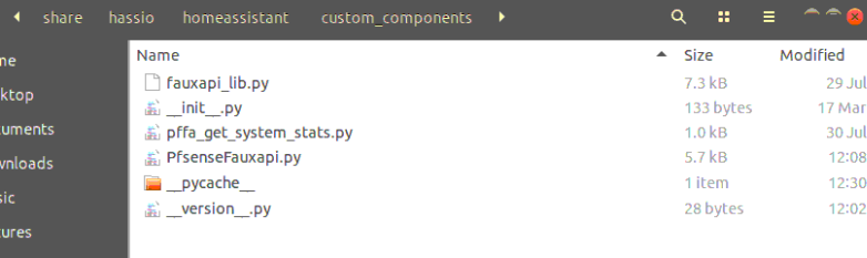

Just come back to try installing this again. I put all following files in ‘/usr/share/hassio/homeassistant/custom_components/pfSense’ folder:
I tried running the python directly by command line and got the import error (either using sudo or not, get the same error)
I’m not sure why it got import error. Need your help…thanks.
OK. I managed to get it working. Here are what the instruction may have to be amended on the HASSIO installation side (step 4 in OP onwards):
0. There are 3 files that we need to put into our Homeassistant folder (for me, I put them into /usr/share/hassio/homeassistant/custom_components/pfSense):
PfsenseFauxapi.py, pffa_get_system_stats.py (can be any name), and "_version_.py"
  1. All the three .py files must be in a same directory
  2. Inside the PfsenseFauxapi.py, line no. 24, we have to delete the ‘.’ (dot) from the "from .__version__ import __version__", to read as "from __version__ import __version__"; otherwise, it will report error
  3. Inside the pffa_get_system_stats.py, I need to change every ‘Fauxapi’ to be ‘PfsenseFauxapi’; otherwise, it will report ImportError: cannot import name ‘Fauxapi’. I don’t know why, but changing it makes it work.
  4. The sample configuration.yaml above needs to insert “Platform: file” and “file_path” after the command-line (see my config below).
