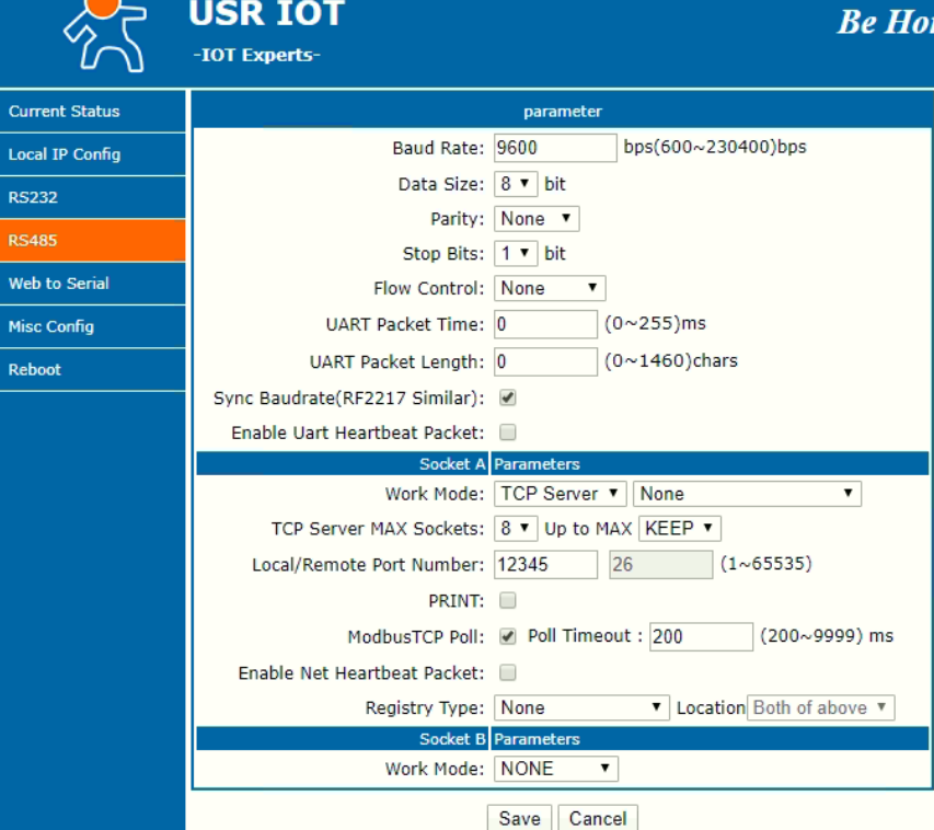

I have the USR Usr-Tcp232-410S RS232 / RS485. I manged to get stuff working around my house. You need to set up the correct parameters in the RS485 tap.

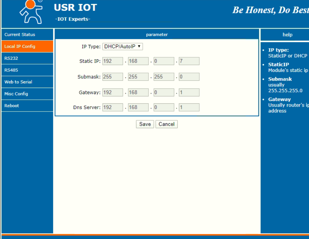

in the debug I can see that it is referring to it. I will share my setting of the USR RS485 < to > IP that I have in case you use it.

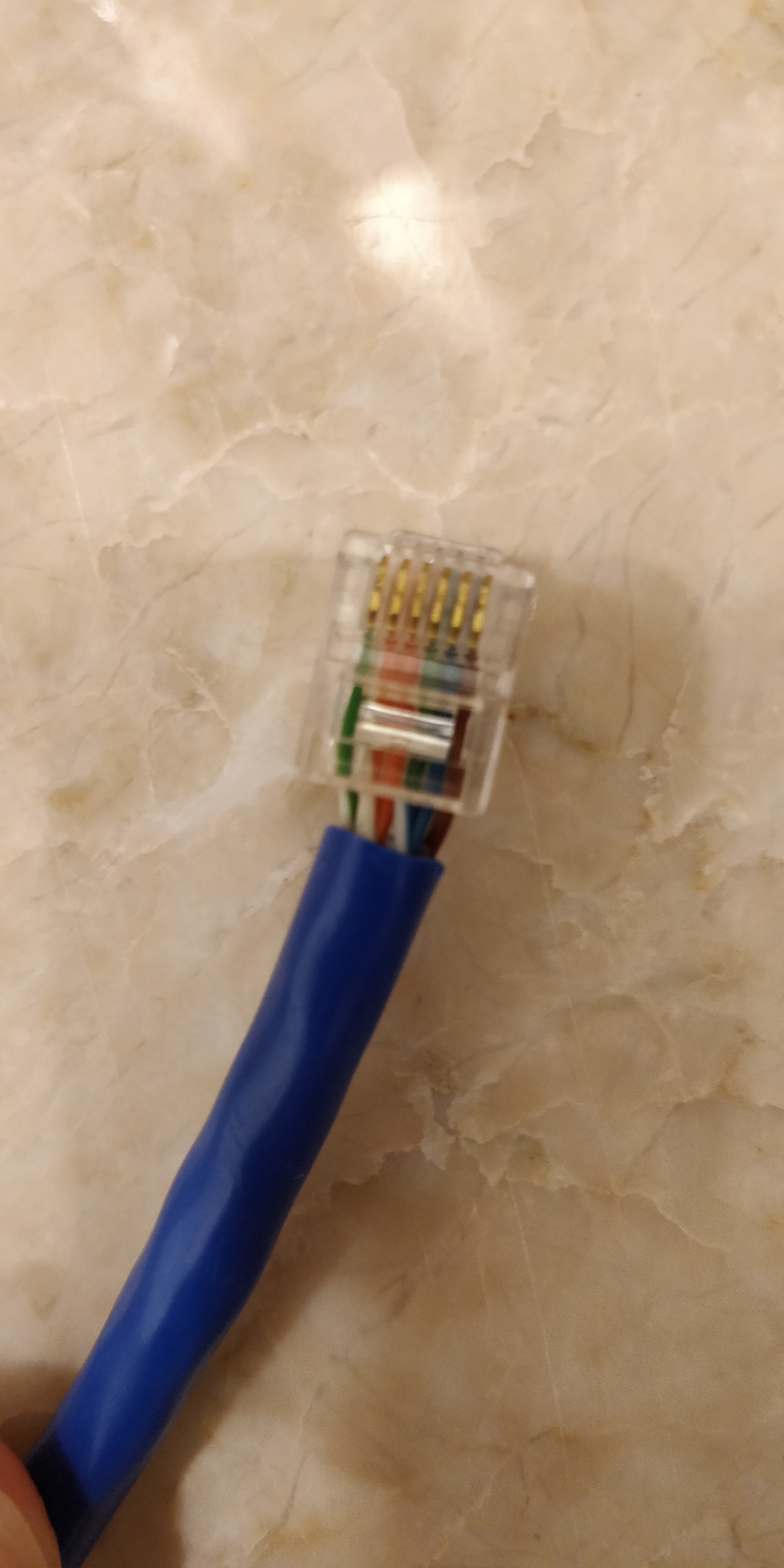

Attached is my wiring and where I have connected it using rj12 / 6 pins
The color coding is random for me, excuse my mess :grin:

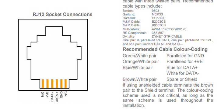

Your power looks like brown and blue both go to 12+ ?
My wiring is a mess, I have followed the diagram below. Color code is definitely wrong since I’m using cat6 cable.
I think I need to remove some wires, thank you for noticing that!
