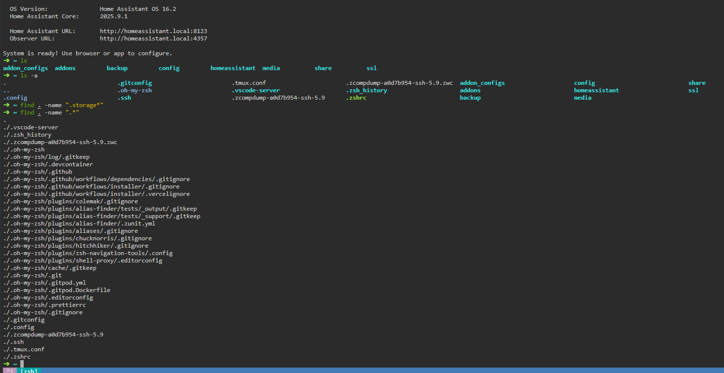

I’m not seeing anything named input_text in /config/.storage/ (all I can seem to get to with Studio Code Server), is there a .storage before config that I need to be accessing? If so, can you point me in the right direction on how I would get to that? Studio Code Server seems to be locking to /config/ as the root
Files or folders that start with a . are usually considered hidden, and for good reason: your .storage folder will be full of internal files (auth, core, lovelace, etc.) that are not considered user-editable. I don’t know anything about Studio Code Server but perhaps it is hiding hidden files, in which case, perhaps there is an option to reveal them.
Do you happen to know the location I should be looking in for the .storage folder? I’m not seeing it at the root and can’t find anything with find. Thanks again!
In that screenshot you’re in your homedir (~). I don’t know where the Home Assistant install is relative to that on HAOS.
I can see from your first ls that there’s a config folder there. If that’s it, the command would be ls config/.storage.
I see there’s also a homeassistant folder in your homedir, you could try ls ~/homeassistant/config/.storage.
