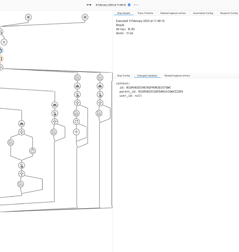

Changed to this and still nothing… im obviously doing something wrong and I expect its quite obvious to some but not me! appreciate any help
Can you show me the “changed variables” tab?
Yeah but I think you need to click on the step above - one of them should show me the trigger data… maybe even the first step
Thanks, some progress it is working now, kind of… anything I set as single click works but double click onwards doesn’t work
multi button press wasn’t selected… All working now. Thanks for the help.
