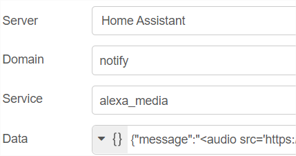

In node-red you need
with
JSON:
    "message": "<audio src='https://your_url/local/media/koekoeksklok-conv.mp3'/>",
    "data": {
        "type": "tts"
    "target": "media_player.your_echo_dot"
