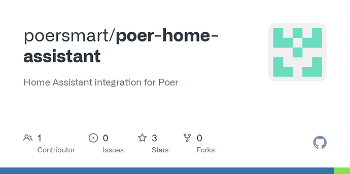

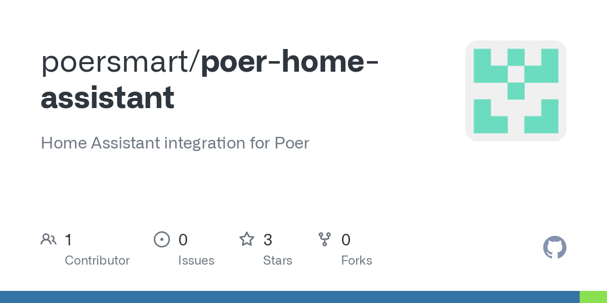

Friends! Congratulations! Now we have integration!
I talked to the developers of the thermostat for 3 months and persuaded them to do the integration! )
You can install the integration using the link to GitHub.
You can get the key in the PoerSmart application. Already tested. everything works. Using an artificial interface, I modified the integration and added the individual sensors I needed (temperature, humidity)
Just tested, it works. Just add repository to hacs, install, reboot and use api key from poersmart app
