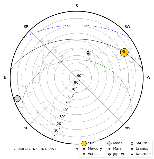

The solution most likely is to make a Hass.io add-on, which is a docker image itself. In the Dockerfile of that add-on image I can install numpy and matplotlib easily enough. This is my plan for hassio support. I havenāt made a hassio addon before but it looks pretty doable.

OK, got it work under 107.7
