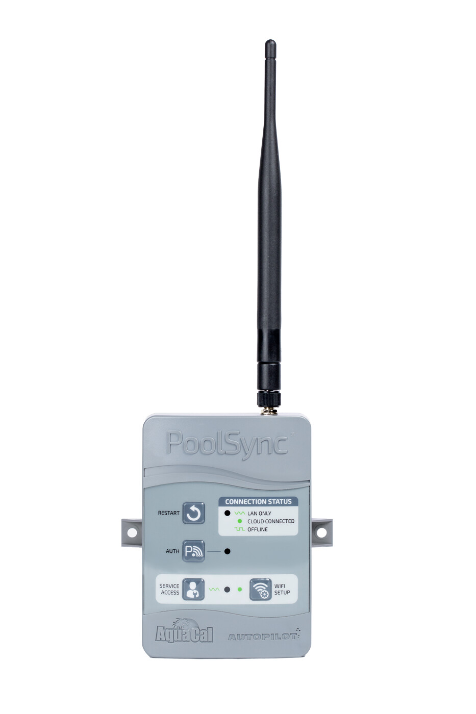

Has anyone been able to link the PoolSync integration to the newer style PoolSync device that looks like below? When I enter the IP address from setting up the integration, it goes to a blank screen (which is fine from the readme) and then I click the service button (light starts to blink). It counts down and eventually timeout.
@jaaem - since you did a PR for this, do you have any thoughts on my post above?
That is the same device I have. Integration works fine.
Mine also shows a blank box (no text) with a submit button when setting up, but it connects just fine. You want to click the AUTH button, not the service button!
That’s what the issue was, auth button worked great. Thanks!!

When setting up in Home Assistant, after submitting the IP address, it goes to a blank screen with a Submit button. This is when I pressed the Auth button on the phsyical PoolSync device, and then the Home Assistant integration found it and all of the sensors.
