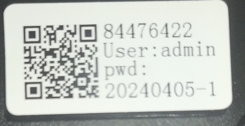

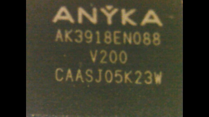

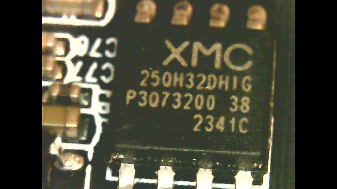

I got two more cameras from Temu:
Store: Wireless Security Camera Three Antennas Wifi Surveillance - Temu
App: https://play.google.com/store/apps/details?id=com.macrovideo.v380pro
Default Hostname: aliosthings
Default AP Hotspot Name: MV84476422
PCAP: cam-reverse-engineering/Wireless Security Camera Three Antennas Wifi Surveillance - Temu/PCAPdroid_06_Aug_17_35_01.pcap at main ¡ Bluscream/cam-reverse-engineering ¡ GitHub
(cam2 and cam4 are the temu cams)
Telegram_peOcGjZMgU
Mirror: cam-reverse-engineering/Wireless Security Camera Three Antennas Wifi Surveillance - Temu at main ¡ Bluscream/cam-reverse-engineering ¡ GitHub

first camera that I bought of this type. V380 app, was able to enable rtsp and has been using for 3 years
it was placed outside, sticked to corner of the window.
was wondering would it be possible to transfer firmware from this one to a9
have tried to open it and check the chip. Device has been outside exposed to elements(-20C…+30C) round the year and it kept working. The battery has expanded quite a bit and when I tried to remove it, it has peeled part of the chip, literally. I thought I broke the device.
I’m unable to read chip identifier, so your guess would be as good as mines.
compared side by side it looks quite a different device and has lot more components.
my guess would it is not possible to transfer firmware…
