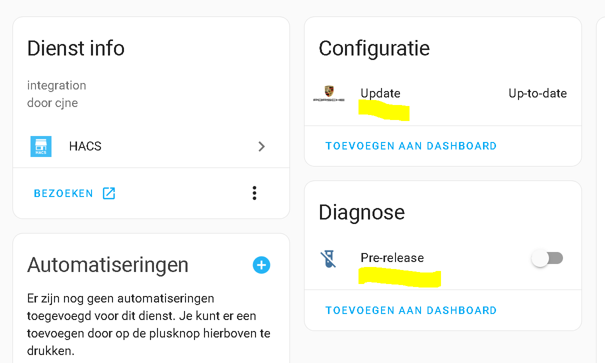

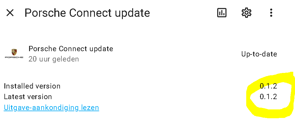

Like a said, it’s “working” as the connection is okay (see below with version 1.2) But i only get two parameters, e.g. : Update and Pre-release. Is the are way to get the GPS-information for example?
