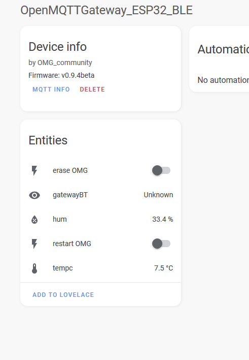

Thanks, Mi flora device is a separated entity not linked to OMG device, did you took a look into the entity registry?
Indeed they are in the entities but not attached to the entity of OMG. Is there a way to do that, would be easier to find them.
It was the case before but I didn’t find it logical :slight_smile: , My thought was to differentiate entities according the physical devices separation. But maybe this is not the good approach in HA?
For me it should be managed together, that’s indeed more like HA approach. Can this be changed in the future?

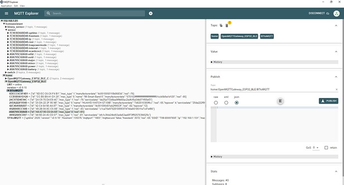

Hello I have the version of OpenMQTTGateway v0.9.10 before I had a version 0.98 and I was using inkbird 2x as well if it saw it as 4x, today I put the latest version the 0.9.10 and I find that instead of seeing it 2x or 4x I am IBEACON Gneric as in the photo, but does not see the correct name like “inkbird2xs_temp1” why ??? I had read that it was detected automatically
thank you
Could you connect to the mqtt broker of your home assistant with mqtt explorer and give me some screenshots of the BTtoMQTT topic please. Especially of the topic with the MAC address of your device.
