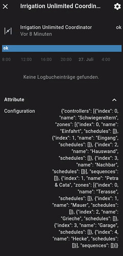

can anyone tell me what the Irrigation Unlimited Coordinator is?
Unfortunately I didn’t find anything in the description.
Thank you.
Oh, by the way, very good integration.
Here is a screenshot of my irrigation, if you are interested
The coordinator is a component entity and serves the integration. The reload service call for example is directed here. Along with its associated class it sits on top of the tree driving the controllers and zones. Mostly handles the config loading, clock, service calls and testing. It is also used to export some of the configuration data and acts as a bridge to the manual run card. The format is json and is easily consumed by other languages providing a possible link to other front end cards.
It is not intended to control anything like a valve but more of a gateway to HA and other integrations. I will leave it open for suggestions on what other information to output that might be useful.
