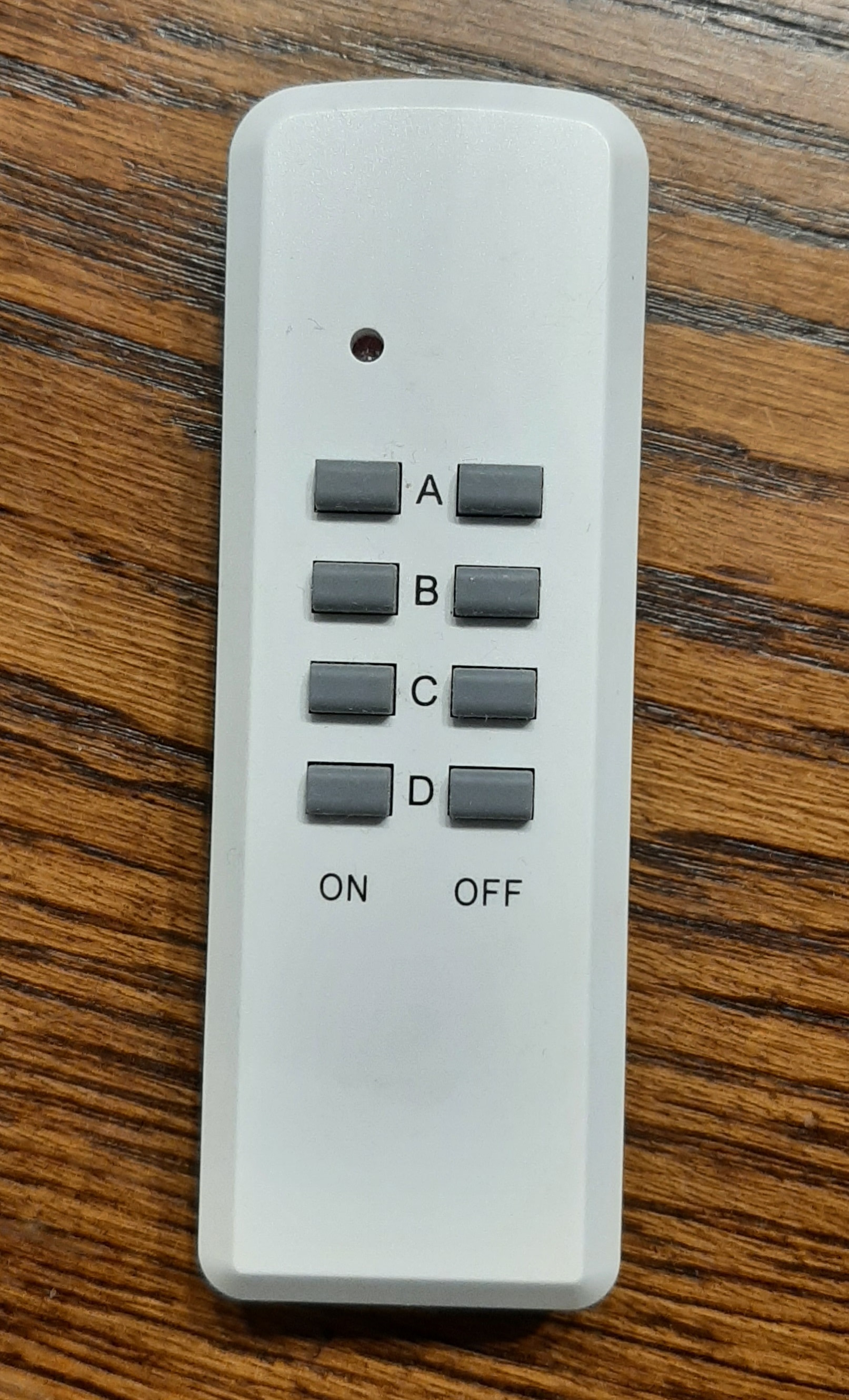

I added a 433 MHz SRX882 receiver to my homemade voice assistant (ESP32‑S3‑N16R8 + MAX98357 + ICS‑43434) for a small handheld remote with four on/off switches so I can also switch some lamps manually (for example when my wife is already asleep). That mostly works quite well, but sometimes the 433 MHz receiver fails completely. The voice assistant keeps working, and all sensors and components (BME680, HC‑SR501 PIR, BH1750, 100‑LED addressable strip, reed switches, ...) continue to function; only the SRX882 receiver stops receiving anything according to the log file and the switch behavior. He is like dead. If I disconnect the whole system from power and reconnect it, the 433 MHz receiver works again immediately. It seems the SRX882 receiver module occasionally fails. I have already tried three different SRX882 receiver modules (two slightly different models), but the problem persists. Has anyone successfully solved a similar problem or can offer tips on how to find and fix the cause?
