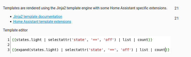

adding my bit: just discovered we can also expand the domain, as an alternative:
count
{% set lights = expand(states.light)
|selectattr('state','eq','off')|list|count %}
{{lights}}
list:
|selectattr('state','eq','off')|map(attribute='name')|list %}
{{lights}}

What’s the purpose of expanding the domain?
The result of the following two templates is the same so the expansion seems like an unnecessary step.
yes…
noticed that myself… first thought the one was listing as list, and the expand as comma separated, but they are not. they are identical. How odd.
(aware of |list versus |join(',') )
sorry for the confusion.
The expand function is useful if you want to combine domains (or groups or entities). For example, this counts how many light and switch entities are off.
ha, that’s very nice indeed, never saw that before in 1 template. in the cookbook!
thanks Taras.
