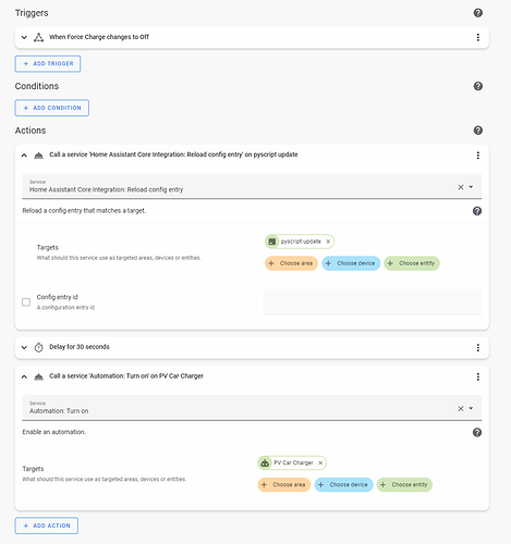

Hello all.
I have also some issues to re-enable automations in the morning again - therefore I want to write down my experience here; perhaps the issue can be found with the support of the community.
Some automations are disabled at night and turned back on in the morning with an automation.
I think this is nothing special and here are a lot of example automations to do this.
Sometimes the pyscript is realising the activation (visible in the log), sometimes not.
In my case it seems, that when I restart home assistant with disabled automations, the pyscript does not recognize when they are enabled again afterwards.
When I do not restart home assistant in this period, it seems that all is working as expected.
What do you think? Do you have the same use case when the ā€œre-enable issueā€ occurs?
Here is my automation in the UI :

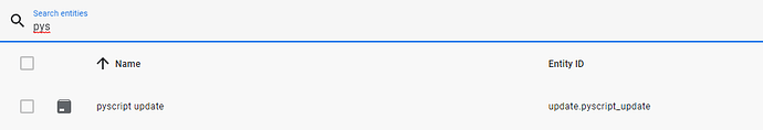

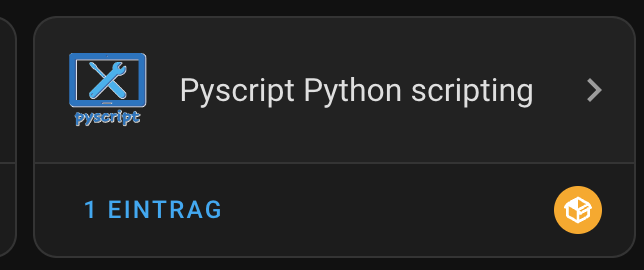

Well, I can not select/find your service my HA installation; maybe I’m being stupid :slight_smile:
→ I expect its the second one in my list. :innocent:
But the entity with pyscript is not existing, really.
I assume you have pyscript in your integrations?
This then gives this single entity that lets HA know which integration to reload.
Well, here is somehow the difference.
I have no idea what wents wrong or how to get the missing stuff.
OK - you will have to do it by Config Entry ID (the tickbox)

Strange as it works 100% for me - this automation is turned off every morning at 7am for 2.5 hours, and then turned on - make sure your automation matches mine as in reload, delay 30s, re-enable automation.
