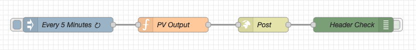

This goes inside a function node. Here’s a complete flow:
[{"id":"2168eae5932e10ca","type":"debug","z":"c7434384.70251","name":"Header Check","active":false,"tosidebar":true,"console":false,"tostatus":false,"complete":"true","targetType":"full","statusVal":"","statusType":"auto","x":710,"y":1880,"wires":[]},{"id":"94287b6905ebc2f4","type":"http request","z":"c7434384.70251","name":"Post","method":"POST","ret":"txt","paytoqs":"ignore","url":"","tls":"","persist":false,"proxy":"","insecureHTTPParser":false,"authType":"","senderr":false,"headers":[],"x":530,"y":1880,"wires":[["2168eae5932e10ca"]]},{"id":"44a1c730d435d36d","type":"function","z":"c7434384.70251","name":"PV Output","func":"var d = moment().format(\"YYYYMMDD\");\nvar t = moment().format(\"HH:mm\");\nvar v1 = global.get(\"homeassistant.homeAssistant.states['sensor.solar_daily_energy_peak'].state\")*1000;\nvar v2 = global.get(\"homeassistant.homeAssistant.states['sensor.total_solar_power'].state\");\nvar v3 = global.get(\"homeassistant.homeAssistant.states['sensor.consumed_daily_energy_peak'].state\")*1000;\nvar v4 = global.get(\"homeassistant.homeAssistant.states['sensor.total_consumed_power'].state\");\nvar v5 = global.get(\"homeassistant.homeAssistant.states['sensor.edmonton_temperature'].state\");\nvar v6 = global.get(\"homeassistant.homeAssistant.states['sensor.utility_2_voltage'].state\");\nmsg.payload = {\n d: d,\n t: t,\n v1: v1,\n v2: v2,\n v3: v3,\n v4: v4,\n v5: v5,\n v6: v6\n}\nmsg.action = msg.payload\nmsg.headers = { \n 'X-Pvoutput-Apikey': 'xxxxxxxxxxxxxxxxxxxxxxx',\n 'X-Pvoutput-SystemId': 'xxxxxxxxx',\n 'Content-Type': 'application/x-www-form-urlencoded'\n};\nmsg.url = \"http://pvoutput.org/service/r2/addstatus.jsp\";\nreturn msg;\n\n","outputs":1,"timeout":"","noerr":0,"initialize":"","finalize":"","libs":[{"var":"moment","module":"moment"}],"x":350,"y":1880,"wires":[["94287b6905ebc2f4"]]},{"id":"ee0c4287ff0f128f","type":"inject","z":"c7434384.70251","name":"Every 5 Minutes","props":[{"p":"payload"},{"p":"topic","vt":"str"}],"repeat":"300","crontab":"","once":false,"onceDelay":0.1,"topic":"","payload":"","payloadType":"date","x":140,"y":1880,"wires":[["44a1c730d435d36d"]]}]

Hi @Jay95.
Here is my latest flow. You will need the Moment node to make it work.
Also my sensor names are probably different than yours.
[{"id":"8e2e2f4c4fd42bd7","type":"function","z":"9abffacc.573c48","name":"PV Output","func":"var d = moment().format(\"YYYYMMDD\");\nvar t = moment().format(\"HH:mm\");\nvar v1 = global.get(\"homeassistant.homeAssistant.states['sensor.solar_daily_energy_peak'].state\")*1000;\nvar v2 = global.get(\"homeassistant.homeAssistant.states['sensor.total_solar_power'].state\");\nvar v3 = global.get(\"homeassistant.homeAssistant.states['sensor.consumed_daily_energy_peak'].state\")*1000;\nvar v4 = global.get(\"homeassistant.homeAssistant.states['sensor.total_consumed_power'].state\");\nvar v5 = global.get(\"homeassistant.homeAssistant.states['sensor.edmonton_temperature'].state\");\nvar v6 = global.get(\"homeassistant.homeAssistant.states['sensor.utility_2_voltage'].state\");\nmsg.payload = {\n d: d,\n t: t,\n v1: v1,\n v2: v2,\n v3: v3,\n v4: v4,\n v5: v5,\n v6: v6\n}\nmsg.action = msg.payload\nmsg.headers = { \n 'X-Pvoutput-Apikey': '*****************',\n 'X-Pvoutput-SystemId': '12345',\n 'Content-Type': 'application/x-www-form-urlencoded'\n};\nmsg.url = \"http://pvoutput.org/service/r2/addstatus.jsp\";\nreturn msg;\n\n","outputs":1,"timeout":"","noerr":0,"initialize":"","finalize":"","libs":[{"var":"moment","module":"moment"}],"x":450,"y":700,"wires":[["5012a069e06b2374"]]},{"id":"5012a069e06b2374","type":"http request","z":"9abffacc.573c48","name":"Post","method":"POST","ret":"txt","paytoqs":"ignore","url":"","tls":"","persist":false,"proxy":"","insecureHTTPParser":false,"authType":"","senderr":false,"headers":[],"x":630,"y":700,"wires":[["f704d04765d66902"]]},{"id":"09245f50958dd8ae","type":"inject","z":"9abffacc.573c48","name":"Every 5 Minutes","props":[{"p":"payload"},{"p":"topic","vt":"str"}],"repeat":"300","crontab":"","once":false,"onceDelay":0.1,"topic":"","payload":"","payloadType":"date","x":240,"y":700,"wires":[["8e2e2f4c4fd42bd7"]]},{"id":"f704d04765d66902","type":"debug","z":"9abffacc.573c48","name":"Header Check","active":false,"tosidebar":true,"console":false,"tostatus":false,"complete":"true","targetType":"full","statusVal":"","statusType":"auto","x":810,"y":700,"wires":[]}]
