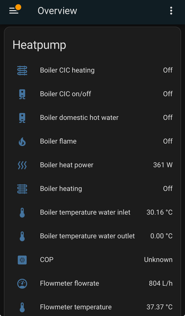

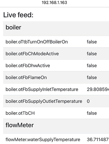

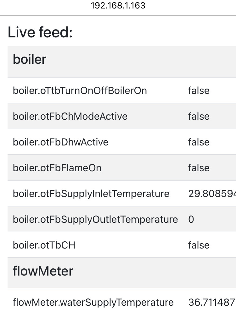

Hi, I’m using this integration for a few weeks now and am really happy with it.
One question: I seem to miss the “Heatpump Boiler temperature outlet”. Ant idea what could be the cause?
The CV is using opentherm. It’s a Intergas Kombi Kompakt HRE 36/30A.
So this one is always 0 and not showing the expected value: boiler.otFbSupplyOutletTemperature
Where can I find the pictures?
It could be that some openTherm boilers do not supply this value. Therefore it is best to use the flowMeter.waterSupplyTemperature. This sensor is placed by Quatt at the flowmeter just after the boiler.
