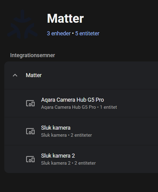

is it possible to turn off the recording and turn on the recording with this metod ? how ? I cant get it to work. I’ve sync it to matter in HA
