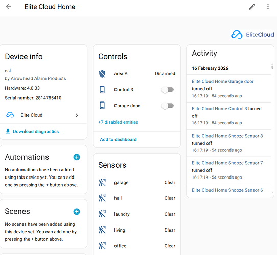

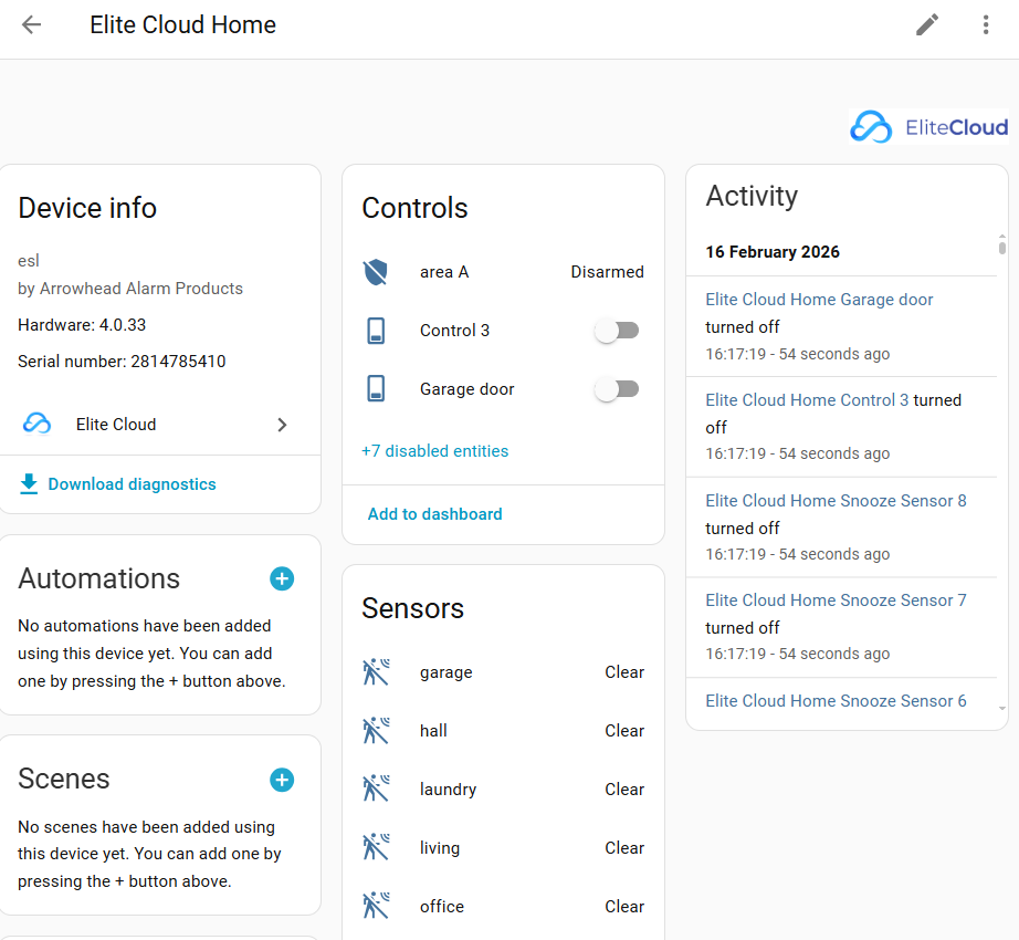

For people who use one of the older model alarms (ESL, ESL-2, Elite S and Elite S), I’ve now made available a new integration for Home Assistant.
It does depend on the newer IoT Module (not the IP Module) and having an EliteCloud account.
It is likely that other alarm devices that are supported via the EliteCloud app will work with this integration as well.
https://github.com/ankohanse/hass-elite-cloud
