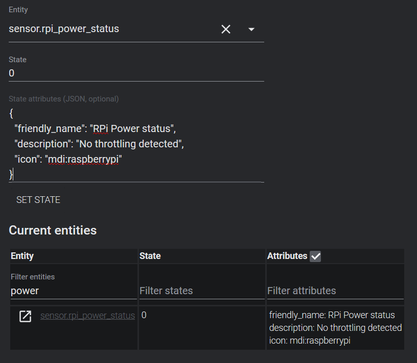

just add this to your sensor configuration and if you get a message about throttling you seriously need to check your power supply so its up to standards.
If there is evidence of throttling you need to replace your power supply because its not good enough and it will cause issues down the line if its powering your Raspberry Pi.
