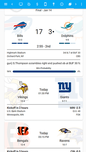

Mine always has. This is tonights view:

OK, to start of course I have one sensor for every team in the NFL. Not all listed here but you get it:
- platform: teamtracker
  league_id: NFL
  team_id: DET
  league_id: NFL
  team_id: GB
  league_id: NFL
  team_id: CHI
  league_id: NFL
  team_id: MIN
  league_id: NFL
  team_id: BUF
Then I use auto-entities with a special trick to display home games. There should always be one home team. In essence, this makes it a “game-tracker” not a “team-tracker”:
type: custom:auto-entities
unique: true
show_empty: false
card:
  type: grid
  square: false
  columns: 4
card_param: cards
filter:
  template: |
    {%- for team in integration_entities("teamtracker") -%}
      {%- if state_attr(team, "team_homeaway") == "home" -%}
        {{{"type": "custom:teamtracker-card",
          "entity": team }}},
      {%- endif -%}
    {%- endfor -%}
  exclude:
    - entity_id: '*team_tracker*'
sort:
  method: attribute
  attribute: date
Essentially the key here is the template filter for custom:auto-entities. It is filtering out only teams that are listed as playing at home. So right now you will only get the playoff games. Note that at the end I exclude the original team setup via the interface so I can track them all more easily by getting just the team names.

Here’s a version that uses custom:layout-card if you have it installed. It better stacks the cards for view on all devices:
unique: true
show_empty: false
card:
  type: custom:layout-card
  layout_type: masonry
card_param: cards
filter:
  template: |
          "entity": team }}},
      {%- endif -%}
    {%- endfor -%}
  exclude:
sort:
  method: attribute
  attribute: date
Phone:
Computer:
Thank you so much for for this!!!
No problem. Not sure what might happen in superbowl but I assume one team is listed as home team
