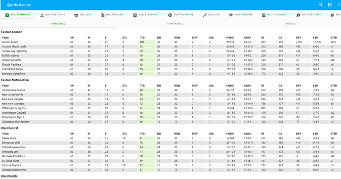

I thought I would post this here for everyone to use/comment/change as you please.
I created a Dashboard Side Panel that uses decluttering and tabbed cards for all NHL, MLB, NFL standings and PRE, IN and POST stat views (sorry NBA fans!)
It uses three main REST sensors to get the overall stats and then template sensors for each conference. Of course it uses teamtracker for individual teams for each of the sports, not posted here.
Some examples:
NHL Standings by Division:
NHL Standings Overall:
NHL Pregame:
The sensors are defines in my included sensor.yaml as follows. Note that I also set seasontype in the query to “2” to get the regular season. This is not built for pre-season although it could be easily done if you wanted pre-season stats.

And the whole dashboard is like this:
decluttering_templates:
  nhl_settings:
    card:
      type: custom:flex-table-card
      title: '[[title]]'
      css:

Big thanks to @Ildar_Gabdullin for assistance in this, sorry for pestering until I understod how things work in flex-table. And I have to say I am now in process of moving many things to use decluttering. That dashboard would have 20 times the lines of code without it.
I got the standings and stats working, however I can’t get the PRE, IN, and POST to show anything. Where did you define these sensors? I found the post here: Real-Time Sports Scores w/ TeamTracker and TeamTracker-Card (Beta) - #230 by kbrown01 but it’s still not showing me anything in the games tabs and I have a red circle exclamation mark with no text (sort of indicating an error in the dashboard code)
I fixed this. Not only was I missing the custom card layout-card, there was also an incorrect double quote character around the custom:teamtracker-card on line 237. Also the NFL Pregame tab was showing MLB Pregame because the decluttering card had MLB for the sport.
Also, is there a way to make the table dynamic in size or allow horizontal scrolling? on the HA Mobile App the right columns (example: on NHL anything after ‘SOL’) get cut off and there’s no way to view anything after that.

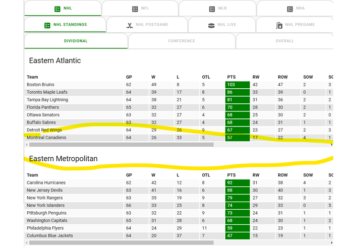

Something like this for scrolling (partial snip from top of decluttering_templates for one of the flex tables):
  nhl_settings:
    card:
      title: '[[title]]'
      css:
        table+: 'padding: 0px; width: 1600px;'
        tbody tr td:first-child: 'width: 20%;'
        tbody tr td:nth-child(n+2): 'width: 5%;'
        tbody tr:hover: 'background-color: lightgreen!important;'
        tbody tr td:nth-child(6): 'background-color: #E3F5D4;'
      card_mod:
        style: |
          ha-card {
              overflow: auto;
            .card-header {
               padding: 12px 0px 8px 4px!important;
               font-size: 16px!important;
               line-height: 18px!important;
               font-weight: bold!important;
So adding a fixed table width (you pick what you like for PC dashboard) and then adding overflow:auto on the ha-card itself. This will allow you to scroll the table left/right.
As for the other issues, I will take a look and be sure all is good. I was creating a Git with all the sensors and dashboard view over the next day (while I added NBA too).
Hmmm, that didn’t work. The fixed width worked, but the overflow: auto did not, I still can’t scroll horizontally. I’ll mess around with the code a bit and see if I can get it to scroll.
What platform? Works on my Windows PC in Chrome and Edge and my Android using Chrome.
Windows 10, chrome. Also tried on the HA mobile app for iOS. I did clear cache and refresh the page.
Not sure, works for me. Here is PC Window shrank which pops the scroll bar:
Here is view scrolled on my Android phone (only top table in multiple stats):

sorry you mean the sensor.nhl_standings.
This looks like:
children:
  - uid: s:70~l:90~g:7
    name: Eastern Conference
    abbreviation: East
    children:
      - uid: s:70~l:90~g:32
        abbreviation: ATL
        standings:
          displayName: Overall Standings
          links:
            - language: en-US
              rel:
                - standings
                - desktop
              href: https://www.espn.com/nhl/standings/_/group/32
              text: Table
              shortText: Standings
              isExternal: false
              isPremium: false
          season: 2023
          seasonType: 2
          entries:
            - team:
                uid: s:70~l:90~t:1
                location: Boston
                abbreviation: BOS
                displayName: Boston Bruins
                shortDisplayName: Bruins
                isActive: true
                logos:
                  - href: >-
                      https://a.espncdn.com/i/teamlogos/nhl/500/scoreboard/bos.png
                    width: 500
                    height: 500
                    alt: ''
                    rel:
                      - full
                      - scoreboard
                    lastUpdated: 2018-06-05T12:12Z
                  - href: >-
                      https://a.espncdn.com/i/teamlogos/nhl/500-dark/scoreboard/bos.png
                    width: 500
                    height: 500
                    alt: ''
                    rel:
                      - full
                      - scoreboard
                      - dark
                links:
                  - language: en-US
                    rel:
                      - clubhouse
                      - desktop
                      - team
                    href: http://www.espn.com/nhl/team/_/name/bos/boston-bruins
                    text: Clubhouse
                    shortText: Clubhouse
                    isExternal: false
                    isPremium: false
                  - language: en-US
                    rel:
                      - clubhouse
                      - mobile
                      - team
                    href: http://m.espn.com/nhl/clubhouse?teamId=1
                    text: Clubhouse
                    isExternal: false
                    isPremium: false
              stats:
                - name: otLosses
                  displayName: Overtime Losses
                  shortDisplayName: OTL
                  description: Number of Overtime Losses
                  abbreviation: OTL
                  type: otlosses
                  value: 5
                  displayValue: '5'
                - name: clincher
                  displayName: Clincher
                  shortDisplayName: CLINCH
                  description: Clinched Playoff Berth
                  abbreviation: CLINCH
                  type: clincher
                  value: 2
                  displayValue: x
                - name: differential
                  displayName: Average Point Differential
                  shortDisplayName: DIFF
                  description: Average Point Differential
                  abbreviation: DIFF
                  type: differential
                  value: 1.6999999999999997
                  displayValue: '+1.7'
                - name: gamesBehind

It the lower level (template) one has the data, it is being taken from the REST one. It is not clear what is wrong. I can only think that you do not have decluttering installed. If you right click and debug in browser, can you see any errors in the console? Not sure the error is coming from the change in Boston stats which I am in process of fixing now, but mine has the data … it is just wrong as they added a field and changed the positional index for Boston only.
As stated above, I am fixing this now to use names to locate the fields and not positional information.
