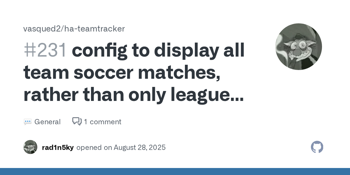

One of the most popular requests has been a way to return all the matches for a soccer team across all of the leagues and tournaments they play in.
Github user rad1n5ky discovered that using all as the value for league_path when setting up a custom configuration and with the team_id set to the unique ESPN 3 or 4 digit Team ID will pull back all matches for the team across all leagues and tournaments.
Thanks to user rad1n5ky for the great find!
Details at the link.

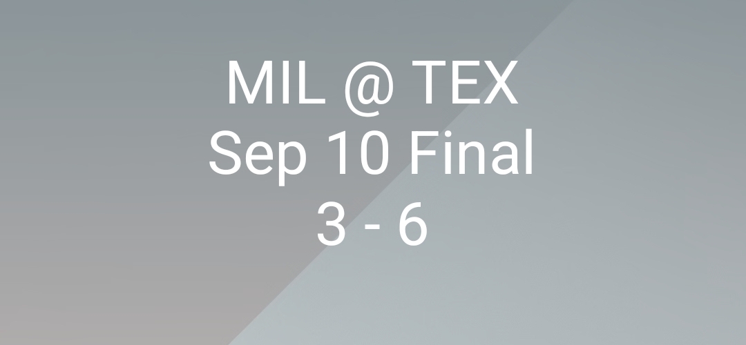

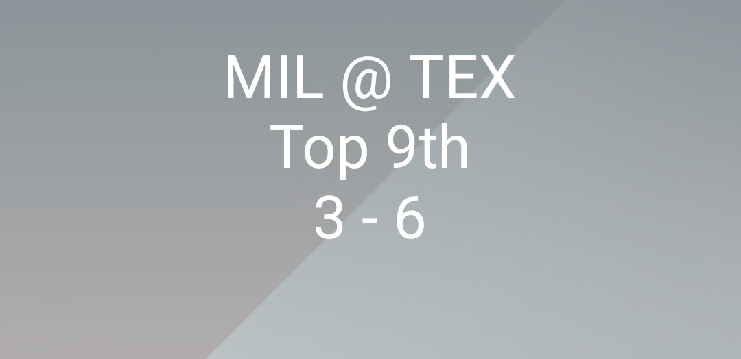

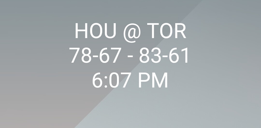

Not sure if anyone else would want this, but posting just in case. It uses the TeamTracker sensors.
The Android app allows you to create widgets using items in HA. I didn’t always want to open the app and change screens to see sports scores.
So, I created a template widget on my phone. It is good for one team at a time. I use an input_select helper to pick the team I want it to display. You can list your favorite team from each sport. Then just change the input_select when seasons change.

Long press on your screen, choose widgets, scroll to HA and select the Template widget. Paste the following into the template

I set the text size to 35, theme to transparent, and text color to white.
Before a game starts, it looks like
While the game is playing, it looks like
End of game is
Hope it is useful to someone.
I made a change from figuring out the sport and using quarters to calculate innings/quarters/period to using the clock attribute which I think does all of that for us. Code changed above. New screen shot posted.
Added %a to starttime in the code above to get the three letter day too. Just time was fine for baseball as we only see what is happening today. But, not for football. I could have used the clock attribute there too. But, I want it local time and wanted the day as opposed to date.

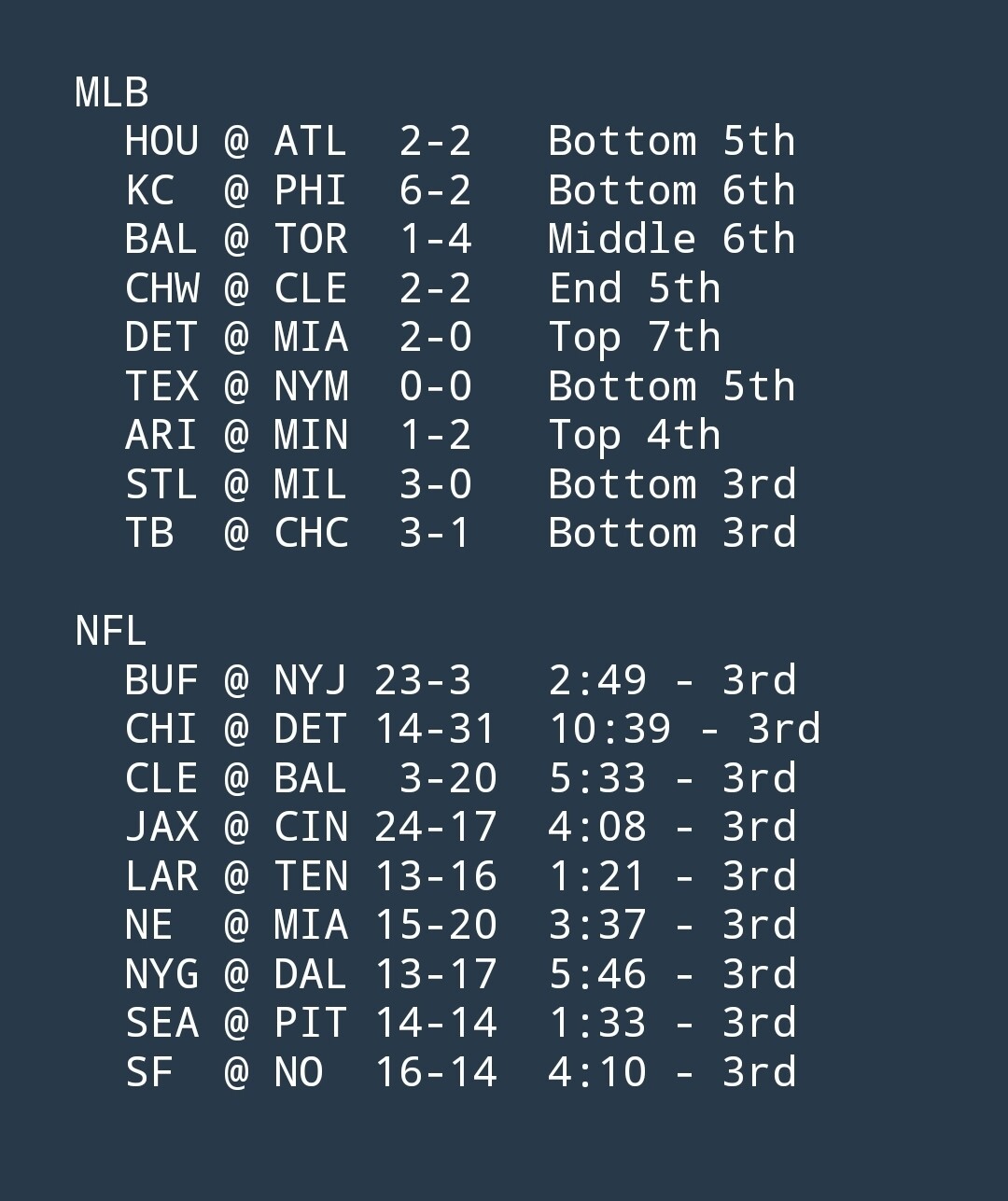

Here is another widget. It shows all of your TeamTracker sensors that are currently playing. So, they have a state of ‘IN’. It groups the games by league and sorts by the date attribute (start time of the game).
Widget text size of 18 seems to work on my phone.

And it looks like
Yes, I am driving my wife nuts with my new toy … HA Widgets :slight_smile:
I added | replace('Rain Delay', 'RD) to the clock output as Rain Delay went too long and wrapped the line.
I added ’ | replace(‘Delayed’, ‘Del)’ after the Rain Delay replace today. The TB @ BAL had that today and it also wrapped the line.
