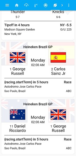

Not sure if this is the expected behaviour for a driver?
Also the tag for race start time
Or i probably should ask what do i enter for drivers name. I was just going by what i see on espn.com.au when i look up a driver
Ok. Was just surname required.
But tags for race start time still an issue
If i can stay awake I’ll have a look during the race tonight. Thank you again
Try clearing your browser cache and refreshing. If that doesn’t work, let me know what language you have selected for your front end and I’ll see if I can replicate it.
Yeah that did it thank you. Am using the companion app. Cleared cache and all good
Great. During the race you should get a scroll of the top 10 drivers and the lap count. It will always show the position of your selected driver and the leader. If you used *, it will always show the top two drivers.
