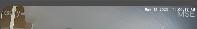

I have an ipad from 2017 and the iOS version is 16.4.1. When I view the stream on the iPad, it shows as MSE. go2rtc version is 1.5.0 and is running as the home assistant add-on. Webrtc card version is 3.1.0.
is there any other information that could help you debug? any way for me to do more debugging considering it’s the ipad and no a full browser that would allow me to run dev tools?
I’ve added WebRTC Camera card to my dashboard but the output is showing MSE. Should it be WebRTC? Or can I select between HLS/MSE/WebRTC by adding something to my card code?
Adding ‘mse: false’ fixed that for me on my iPad.
Put that line under your stream url.
