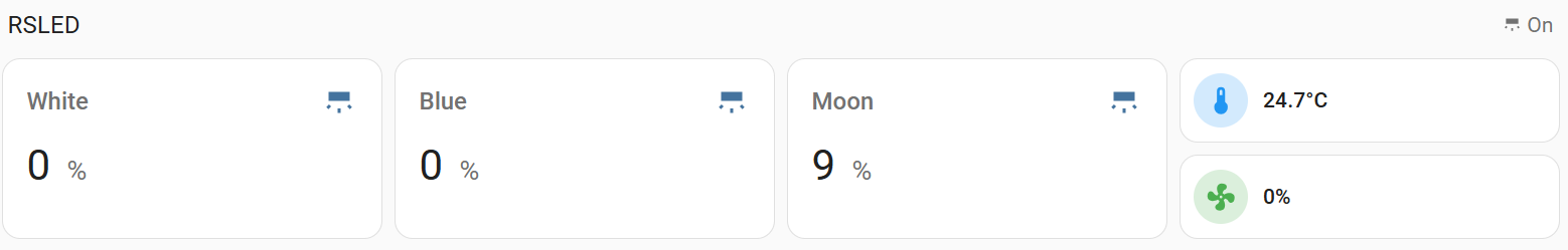

Yes it does, light value change in the ReefBeat app are updated almost at instant in HA. Temperature and Fan speed however are not shown in the ReefBeat app and the on/off state i calculate within the REST value template.

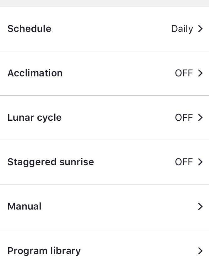

Within the app i saw some similarities in doser endpoints. I tried some with the led and /manual worked. Also /acclimation comes back with data, the other options don’t. So no proxy, just a lucky guess.

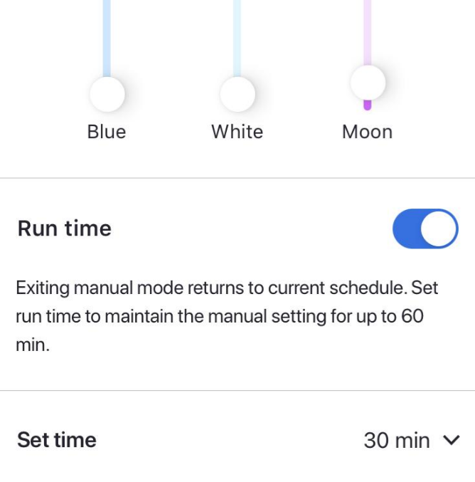

Nice to see you’ve managed to send a post as well. Indeed the ReefBeat app has a run time option for the manual mode. I suspect that there is an additional endpoint path which will get the run timer settings.
I hope you will be able to retrieve some additional endpoints with the proxy!
