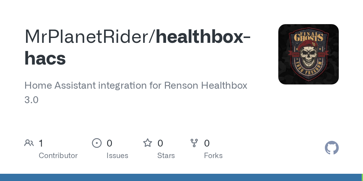

Hi all,
Since the original Healthbox GitHub project is no longer actively maintained, I’ve created a cloned version to continue development.
I’m using a Healthbox 3 myself and have already implemented numerous bug fixes, improved error handling, and general stability updates. I’ll also be integrating the logo and adding new features over time. Contributions and feedback are welcome!
Be aware that you need to delete and remove the previous GIT from rmassch and all you settings will be gone.
Also this version is for now API only. Still need to check.
Regards
