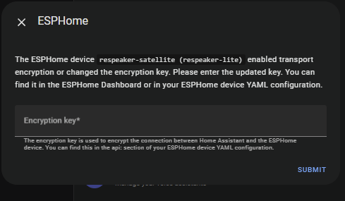

Ok it eventually seems to have connected and asking me for a authentication.
Unable to connect to the ESPHome device. Make sure the device’s YAML configuration includes an api section.
Haven’t got the api section in the main so not sure what to add.
It’s still might be signal strength issue.
API section exists in base file. Don’t search for config troubles, it works.
Ok but I have this…
which is from this
It 2m from router.
At this point it’s just regular ESPHome support.
Please refer to the ESPHome Discord server. I’m there, I will try to help.

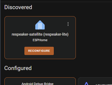

So far it looks like you’ve got several devices with same name. Which might have happened because of friendly name in the common config. Names should be unique.
Omg it clicked the moment read I read what you just wrote. Removed the existing respeaker lite and right away was able to add. thanks for your patience.
