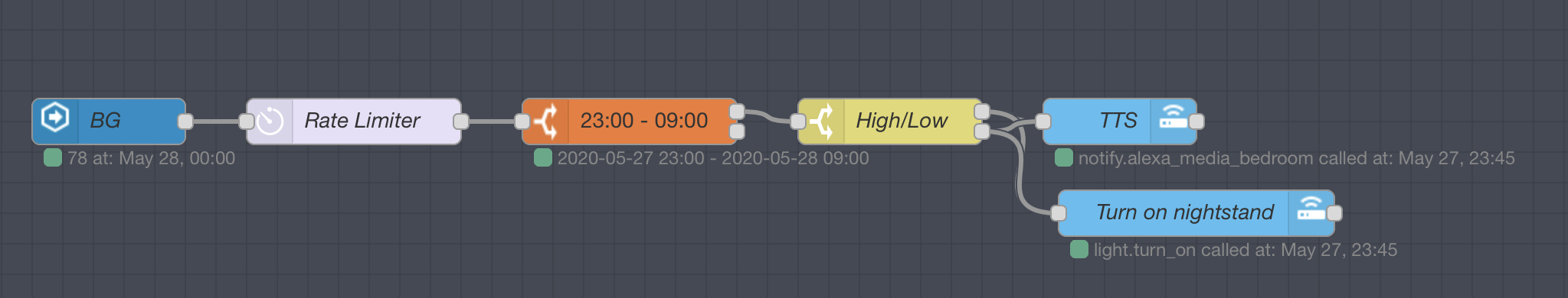

How do you avoid it from triggering every time your BG moves by 1?
i.e., once the alert plays and you bolus, I would imagine you would want it to stop alerting you every minute until your BG is back in bounds.
I have an input boolean that defaults to on. I change it to off (via a switch) and monitor the state in an automation. When it switches to off, it triggers an automation to turn it back on in an hour or so. All of my alarm automations are also tied to the state of that input boolean. They wont trigger if the input boolean is off.
Neat, thanks.
I played around with it this afternoon and ended up using a ‘Delay node’
The node has a ‘rate limit’ function so that I can cap the messages passed through to 1 msg per 30 min.
