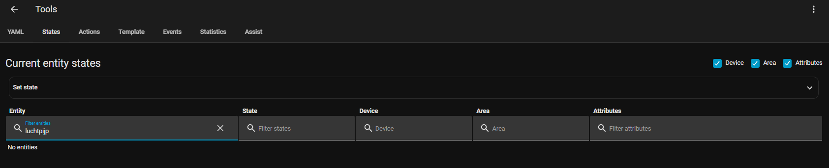

Multiple restarts and update/upgrades.
I went looking for my entities in the Settings → Tools → States

You’re going to have an error then. Post your entire configuration.yaml and any included files.

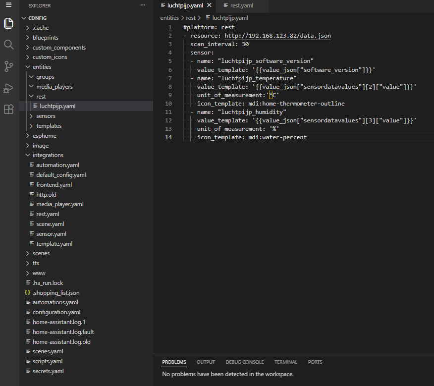

Smeagel21
(Kris)
September 1, 2026, 8:35pm
30
configuration.yaml:
# The configuration.yaml is only used to bootstrap the system.
homeassistant:
# Load packages
packages: !include_dir_named integrations
# IMPORT STATISTICS
import_statistics:
In the Integrations directory there is rest.yaml:
rest: !include_dir_list ./entities/rest
In the “entities” directory there is a subdirectory “rest” which contains the luchtpijp.yaml:
#platform: rest
- resource: http://xxx.xxx.xxx.xxx/data.json
scan_interval: 30
sensor:
- name: "luchtpijp_software_version"
value_template: '{{value_json["software_version"]}}'
- name: "luchtpijp_temperature"
value_template: '{{value_json["sensordatavalues"][2]["value"]}}'
unit_of_measurement:'°C'
icon_template: mdi:home-thermometer-outline
- name: "luchtpijp_humidity"
value_template: '{{value_json["sensordatavalues"][3]["value"]}}'
unit_of_measurement: '%'
icon_template: mdi:water-percent
To make it visual:

That looks correct, there should be an error in your logs if the entity isn’t created. Unfortunately, there’s nothing else we can go off here.
It may be worthwhile just to put the configuration in configuration.yaml directly without the includes to see if that’s your issue.
