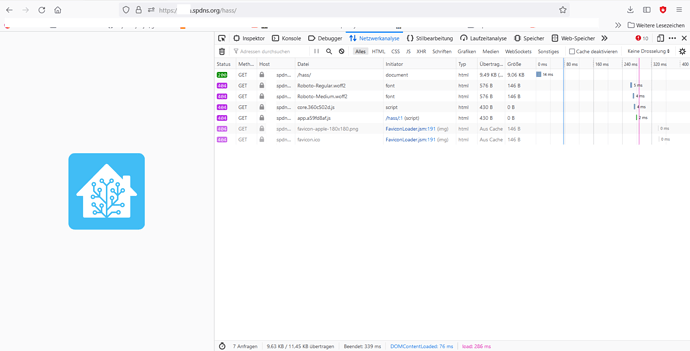

Any other approach? This is what the Browser Inspector is spitting out:

Could you share your config plz? The official documentation and this post doesnât mentoin a token or a websocket usage.
I donât think Home Assistant works well with subdirectories. Try a subdomain instead (e.g. hass.example.com instead of example.com/hass/)

Btw I Use HA supervised on Debian 11 and have a DS-Lite connection (only ipv6)
This is more of an observation than a problem, but given that many of us are trying to run a network that can be self-contained and independent of the outside world, I thought Iâd bring it up. Iâm running HA in a VENV on a mac with Letsencrypt certificates, AdGuard rewrite and NGINX as per the examples. If I shut off the internet connection, to access internally, http://192.168.1.xxx:8123 works fine, but https://subdomain.duckdns.org times out in browsers or in the companion app. For a while I thought that this meant I had proxy_pass set up wrong or something, but then I realized that the NGINX error log shows this:
2022/06/12 11:40:43 [info] 63241#0: *151 SSL_do_handshake() failed (SSL: error:14094416:SSL routines:ssl3_read_bytes:sslv3 alert certificate unknown:SSL alert number 46) while SSL handshaking, client: 127.0.0.1, server: 0.0.0.0:443
⌠which apparently indicates that the browser is trying to verify the siteâs certificate but understandably canât because thereâs no internet connection. So, even though all communication is remaining inside and the rewrite & proxy pass are working, HA isnât accessible via the usual URL because the browser is being obstinate.
I donât know of another solution than to use the internal ip address for HA if the internet is down. Did I miss something?
