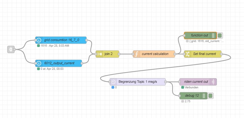

I’ve successfully setup an automatic control for my RD 6012 in Node red now.
As I’m not the specialist in programming thing I’ve used GPT in this case DeepSeek and it works perfect.
