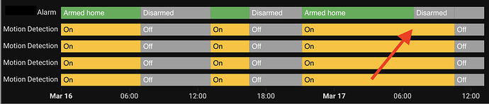

Is anyone experiencing cameras not turning off when the Ring alarm is disabled?
In my ā€œHomeā€ mode I have my outside cameras motion detection turned on. In the Ring app they are all disabled in ā€œDisarmedā€ mode. I have an automation that changes from Home to Disarmed at 7am, but sometimes (a few random times of the week) the alarm is Disarmed, but the motion detection is still enabled. It happened again this morning:
To fix I then go into Home Assistant and manually turn the alarm on to ā€œHomeā€ and then ā€œDisarmedā€ and then the camera motion detection turns off.
I kind of doubt this is an issue with the integration, but curious if anyone else is seeing this. I can add an automation to check for this and turn off the motion detection.

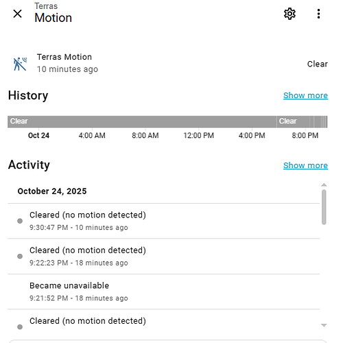

After reading and trying a lot of different solutions I’m a bit lost, how to solve this.
I don’t get motion updates anymore from my stickup cam’s. Allthough I’m seeing the updates in the ring2MQTT addon.
So, in the log you see at 19.33 there’s a motion detected but in the history of the motion entity, there’s nothing showing up. I already deleted the devices in the MQTT integration but it’s not helping.
Does anyone encounter this same issue?
Thx!
2025-10-24T19:33:19.470Z ring-mqtt [Terras] ring/u1540n-2j4rl-0/camera/9c7613184578/siren/state OFF
2025-10-24T19:33:19.470Z ring-attr [Terras] ring/u1540n-2j4rl-0/camera/9c7613184578/motion/attributes {"lastMotion":1761334129,"lastMotionTime":"2025-10-24T19:28:49Z","personDetected":false,"motionDetectionEnabled":true}
2025-10-24T19:33:19.470Z ring-mqtt [Terras] ring/u1540n-2j4rl-0/camera/9c7613184578/motion_detection/state ON
2025-10-24T19:33:19.470Z ring-mqtt [Terras] ring/u1540n-2j4rl-0/camera/9c7613184578/motion_warning/state OFF
2025-10-24T19:33:19.470Z ring-mqtt [Terras] ring/u1540n-2j4rl-0/camera/9c7613184578/stream/state OFF
2025-10-24T19:33:19.471Z ring-attr [Terras] ring/u1540n-2j4rl-0/camera/9c7613184578/stream/attributes {"status":"inactive"}
2025-10-24T19:33:19.471Z ring-mqtt [Terras] ring/u1540n-2j4rl-0/camera/9c7613184578/motion/state OFF
2025-10-24T19:33:19.471Z ring-attr [Terras] ring/u1540n-2j4rl-0/camera/9c7613184578/motion/attributes {"lastMotion":1761334129,"lastMotionTime":"2025-10-24T19:28:49Z","personDetected":false,"motionDetectionEnabled":true}
