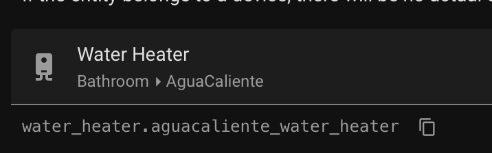

I found the correct entity_id in “Developer Tools > States”, searched on ‘water heater’ and found it:
copy that id to your code- it works for me. Now I can create timers, automations, buttons to set up a circulation even.t
