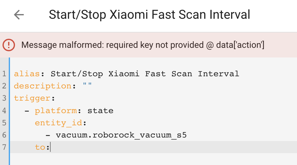

Can please somebody copy the last updated automation codes which works for this?
Because I receive this message, if I copy&paste the following code to a new automation:
That is only the trigger section of the automation. Look further up in the topic.
sorry for ask again, but I dont understand it :smiley:
I copied / changed all 3 codes from here: Roborock Map/Camera is not shown every 24h - #9 by tonka3000
what should I do with the two other codes?
and
They are only sections of the automation I changed to suit my needs. The full automations are posted further up in the topic and marked as the solution to this problem.
