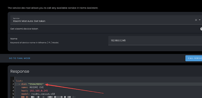

Hello, somewhere I got some practical instructions on how to operate the vacuum cleaner. I can’t find the link, but I’ve processed it myself. Practically they are all available there as in the mi home app.
for some commands you need to get the DID number, which you can get through the miiot service in HA
popup
I believe it’s an issues with Roidmi EVE when trying to operate with local request. In case of Roidmi EVA I didn’t faced this issue. But maybe it’s a case for others, so thank you for posting it here.

To use it, you need bulk rename of:
  • camera.roidmi_eva_vacuum_map - camera entity.
  • vacuum.roidmi_v66_602e_robot_cleaner - vacuum cleaner entity.
  • 1702677612 - you map id.
The important note here is that you need to get you Map_ID, there is only way for now is get it from the logs in modified Mi Home app. I wasn’t able to find better way, and even it’s a recommended approach from plugin developer. If you will not get it - it will not work for you.
Thank you sir ! I will give it a try tomorrow most probably and let you know.
Not sure the kids will like me if I start sweeping at 10.30pm ^^.
Not only that, but also change all the zones ^^
Yes I got that too and have written it down, I’ll check indentation compared to mine and make sure I put all sections in the correct place.
Again, thanks a lot, much appreciated.
Man I feel dumb… Everything I had setup was right. Everything except the internal_variables part.
I defined a mapID … but was using map_id in my service data… :face_exhaling: :face_with_head_bandage: :man_facepalming:
That’s it… In anycase, @eliogrin thanks a lot, since if I didn’t compare your file to mine I probably would have spent a month troubleshooting my mistake.
Everything is working now
I just review my instruction, and there was mistake there. I fixed it now.
Thank you for testing it and glad that you was able to set it up. Let me know if you have any questions or ideas regarding this configuration.
