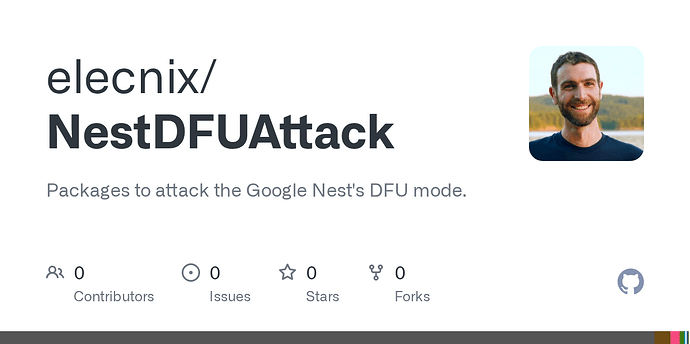

I have attempted several times, and the best attempt got me this far:
found device 0x0451:0xd00e
Active configuration: 1
Interface 0, altsetting 0 has 2 endpoints:
  Endpoint 0x81: type 2, max packet size 512
  Endpoint 0x01: type 2, max packet size 512
Claimed interface 0. Waiting 200ms before transfer...
download ok
while loop size = 246572
filesize = 246572
Error in libusb_bulk_transfer: -1 (Input/output error)
It seems the Nest doesn’t stay in DFU mode long (which is understandable), but even when I am able to initiate a transfer, I always get disconnected:
could not write to usb (res=-9, Pipe error, transferred=0, file_cnt=512)
or
libusb: error [submit_bulk_transfer] submiturb failed, errno=2
could not get ASIC ID (res=-1, Input/output error, transferred=-890893169)
If you are able to get it to work, let me know!

@elecnix I’m gonna try it myself. But im stuck at the end with:
root@Peters-iMac NestDFUAttack % docker run -it -v $(pwd):/workspace nest-build /workspace/Dev/build.sh
WARNING: The requested image's platform (linux/amd64) does not match the detected host platform (linux/arm64/v8) and no specific platform was requested
  β–ˆβ–ˆβ–ˆβ–ˆβ–ˆβ–ˆ β–ˆβ–ˆβ–ˆβ–ˆβ–ˆβ–ˆβ–ˆβ–ˆβ•—β–ˆβ–ˆβ•—   β–ˆβ–ˆβ•—β–ˆβ–ˆβ•—  β–ˆβ–ˆβ•— β–ˆβ–ˆβ–ˆβ–ˆβ–ˆβ•—  β–ˆβ–ˆβ–ˆβ–ˆβ–ˆβ–ˆβ•—β–ˆβ–ˆβ•—  β–ˆβ–ˆβ•—β–ˆβ–ˆβ–ˆβ–ˆβ–ˆβ–ˆβ–ˆβ•—β–ˆβ–ˆβ–ˆβ–ˆβ–ˆβ–ˆβ•—
 β–ˆβ–ˆβ•”β•β•β•β•β•β•šβ•β•β–ˆβ–ˆβ•”β•β•β•β–ˆβ–ˆβ•‘   β–ˆβ–ˆβ•‘β–ˆβ–ˆβ•‘  β–ˆβ–ˆβ•‘β–ˆβ–ˆβ•”β•β•β–ˆβ–ˆβ•—β–ˆβ–ˆβ•”β•β•β•β•β•β–ˆβ–ˆβ•‘ β–ˆβ–ˆβ•”β•β–ˆβ–ˆβ•”β•β•β•β•β•β–ˆβ–ˆβ•”β•β•β–ˆβ–ˆβ•—
 β–ˆβ–ˆβ•‘  β–ˆβ–ˆβ–ˆβ•—  β–ˆβ–ˆβ•‘   β–ˆβ–ˆβ•‘   β–ˆβ–ˆβ•‘β–ˆβ–ˆβ–ˆβ–ˆβ–ˆβ–ˆβ–ˆβ•‘β–ˆβ–ˆβ–ˆβ–ˆβ–ˆβ–ˆβ–ˆβ•‘β–ˆβ–ˆβ•‘     β–ˆβ–ˆβ–ˆβ–ˆβ–ˆβ•”β• β–ˆβ–ˆβ–ˆβ–ˆβ–ˆβ•—  β–ˆβ–ˆβ–ˆβ–ˆβ–ˆβ–ˆβ•”β•
 β–ˆβ–ˆβ•‘   β–ˆβ–ˆβ•‘  β–ˆβ–ˆβ•‘   β•šβ–ˆβ–ˆβ•— β–ˆβ–ˆβ•”β•β–ˆβ–ˆβ•”β•β•β–ˆβ–ˆβ•‘β–ˆβ–ˆβ•”β•β•β–ˆβ–ˆβ•‘β–ˆβ–ˆβ•‘     β–ˆβ–ˆβ•”β•β–ˆβ–ˆβ•— β–ˆβ–ˆβ•”β•β•β•  β–ˆβ–ˆβ•”β•β•β–ˆβ–ˆβ•—
 β•šβ–ˆβ–ˆβ–ˆβ–ˆβ–ˆβ–ˆβ•”β•  β–ˆβ–ˆβ•‘    β•šβ–ˆβ–ˆβ–ˆβ–ˆβ•”β• β–ˆβ–ˆβ•‘  β–ˆβ–ˆβ•‘β–ˆβ–ˆβ•‘  β–ˆβ–ˆβ•‘β•šβ–ˆβ–ˆβ–ˆβ–ˆβ–ˆβ–ˆβ•—β–ˆβ–ˆβ•‘  β–ˆβ–ˆβ•—β–ˆβ–ˆβ–ˆβ–ˆβ–ˆβ–ˆβ–ˆβ•—β–ˆβ–ˆβ•‘  β–ˆβ–ˆβ•‘
  β•šβ•β•β•β•β•β•   β•šβ•β•     β•šβ•β•β•β•  β•šβ•β•  β•šβ•β•β•šβ•β•  β•šβ•β• β•šβ•β•β•β•β•β•β•šβ•β•  β•šβ•β•β•šβ•β•β•β•β•β•β•β•šβ•β•  β•šβ•β•
[I] - Cross compiling u-boot.
[I] - Cross compiling Linux (this could take a few minutes.)
[I] - Cross compiling x-loader.
[I] - Compiling omap3_usbload for host machine.
I don’t know what’s next?

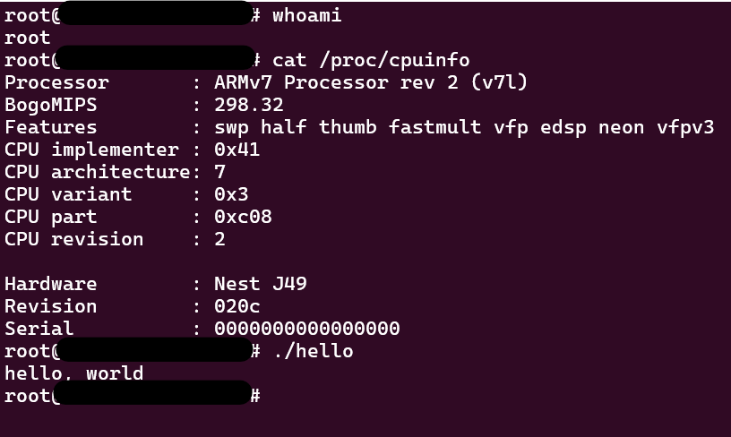

I have root. Also have compiled a simple hello word that runs on the hardware.
I will start working on putting together a repo that allows others to do the same

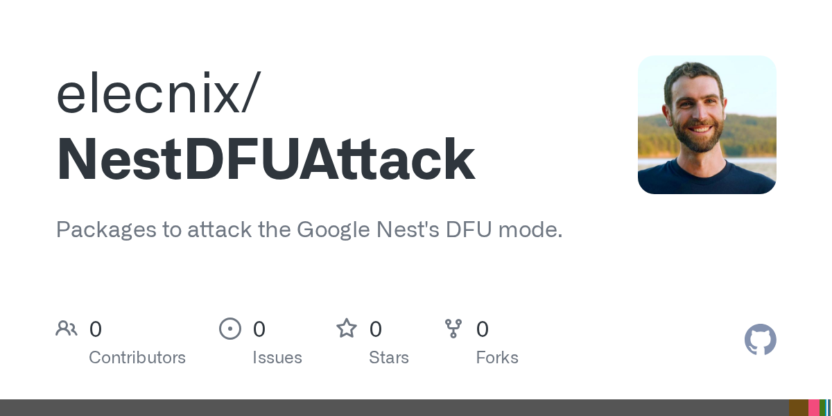

Here is a link to my git repo that should get this working for a few people:
ajb142/cuckoo_loader
I am going to create some more repos with other related stuff, such as the hello world application and some notes on what I have learn so far about the hardware.
I had three thermostats in total (2 x gen 2 and 1 x gen 3). These have all been replaced with a different system but I still think the Nest is a cool bit of HMI that can be used for many things. I plan to make a scene selector for home assistant eventually.

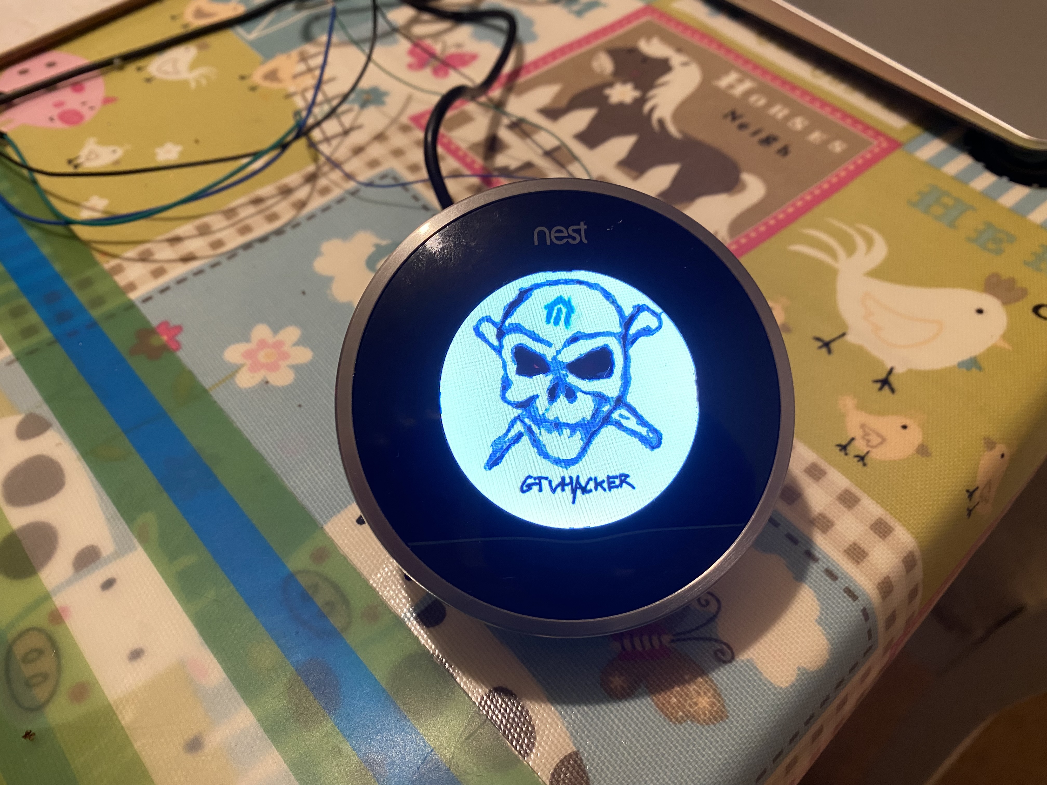

For those struggling to get the original exploit working, these are the reasons why:
It looks like Nest started using different NAND chips at some point. The version of x-loader the exploit sends does not support these chips but a later versions does. I discovered this by attaching serial console cables to my Nest.
The omap3_loader tool is no good on modern computers. I have swapped to a newer project that works. This newer project also needed patching as the jump command (used to launch the kernel) was not in the correct format for x-loader
There where a couple of other build issues with u-boot and linux but easily patched around.
I will not take any responsibility for bricked devices, etc.
Keen to know how people get on. I can only test with what I have so go easy. I know the bash script could be better, I wanted to get something out there as I see there is interest.
