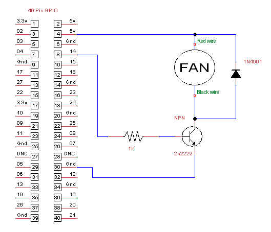

Hello Folks,
I am using Ubuntu 25.10 on Raspberry Pi 3 Model B Rev 1.2 with this kind of hardware and the basic fan
Image from https://community.home-assistant.io/t/rpi4-fan-control/610597/25
(N.B. my transistor is controlled from pin 18 instead of 14)
