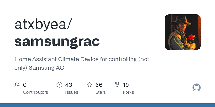

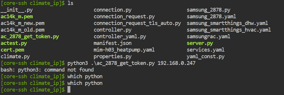

I’ve made a bit easier solution for everybody who has an older model (2878).
I have mocked up a script (with the use of ChatGPT using the js script from one of your sources) to get the token from an old version (2878) AC.
It can be used from a HA terminal like python3 .\ac_2878_get_token.py 192.168.1.100 , just need to include in the same folder the ac14k_m.pem file.
The pem file is here.
For controlling the AC the following integration can be used (you can find it in HACS) once you have the token.
And this is the script to get the Token, just save it as ac_2878_get_token.py.

Hi there, I am trying to get the token using your script.
HAOS is installed in an old laptop.
I am using a desktop PC with win10 (no linux).
I saved the script as .\ac_2878_get_token.py in the custom_components\climate_ip folder of the HAOS system using smb.
when I login into the SSH and try to execute the script I got this error:
python3 .\ac_2878_get_token.py 192.168.0.247
Do I have to mode the script to a different location?
I must have installed python there, to be honest, I don’t know. I thought that HAOS has the python environment installed by default, but don’t worry, the HA container has.
docker exec -it homeassistant /bin/bash
to enter the HA container, and then go to the same directory, and execute the command like you tried, but this is Linux so it will ./ac_2878_get_token.py
Once you executed the script you will need to turn on the AC with the remote, but I think it will give you the instructions. I cannot remember, sorry.
When the AC turns on it will give you the required token and you will be able to set up the integration through the configuration.yaml.
Don’t expect miracles from the AC. The response is quite slow time to time, but generally working.
Let me know if you have any other issues.
Thanks.
The code suggested (docker exec -it homeassistant /bin/bash) gave this output:
bash: docker: command not found
How are you running your HA then? Because that should work without any issues if you have HAOS, and you are accessing it through the SSH addon.
You need a python3 environment to run the script. It is provided inside the HA container, but I have no clue how is that docker command not working for you.
As per this comment, you likely need some further settings to access the container.
Read the comment and the following few others how to access the container. It will get you there.

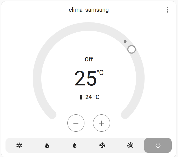

Any success? I know it is a life saver this integration as the original app is not working anymore, unless you have a really old phone to run it. Otherwise you are stuck with the remote or an IR Blaster, but then you don’t have any feedback of the values.
Dear all, I managed to get the token! thanks for the support.
Now is time to configure climate ip.
edit:
I managed to create the new clima-samsung entity, but looks like it’s not working correctly (yet).
The clima is not sending info about the temperature, or simply siwtching on/off.

A little progress: seeing temperature settings.
Still not working: unable to send any command.
I opened an issue in github, but at the moment I have no clue on what I can change in terms of configuration files to make it work.
