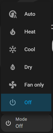

Good news, now the official integration has originalli the - hvac, - fan, - swing control and also the - preset the allow to use windfree
This js the result with simple-thermostat card with only the original integration.
