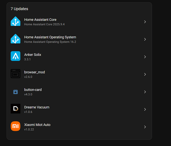

Hi, i used this blueprint in an automation for many months and never had any problems. But e few weeks ago it stopped working. The automation is triggered, but its not updating. I excluded non of the updates, but the list of open updates is getting longer and longer…
Do you see anything related to this in your logs (Settings > System > Logs)?
i think not, but im not sure. can you tell me what i have to look for and where? There are differnet logs avaiable, like Host, Supervisor or Core.
Oh and btw, i did the HA Core and Operating System Updates manually as well as restarting the system. But nothing changed…
