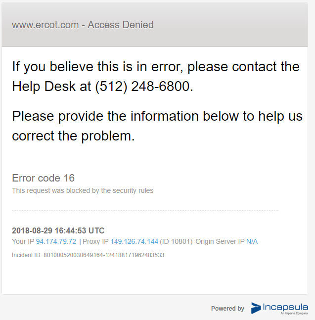

I get this when I click on your link?

I don’t appear able to access the domain. Is it restricted to specific country(ies)?
Can you right click > Source, copy all and paste in hastebin.com and provide the link to it here?
